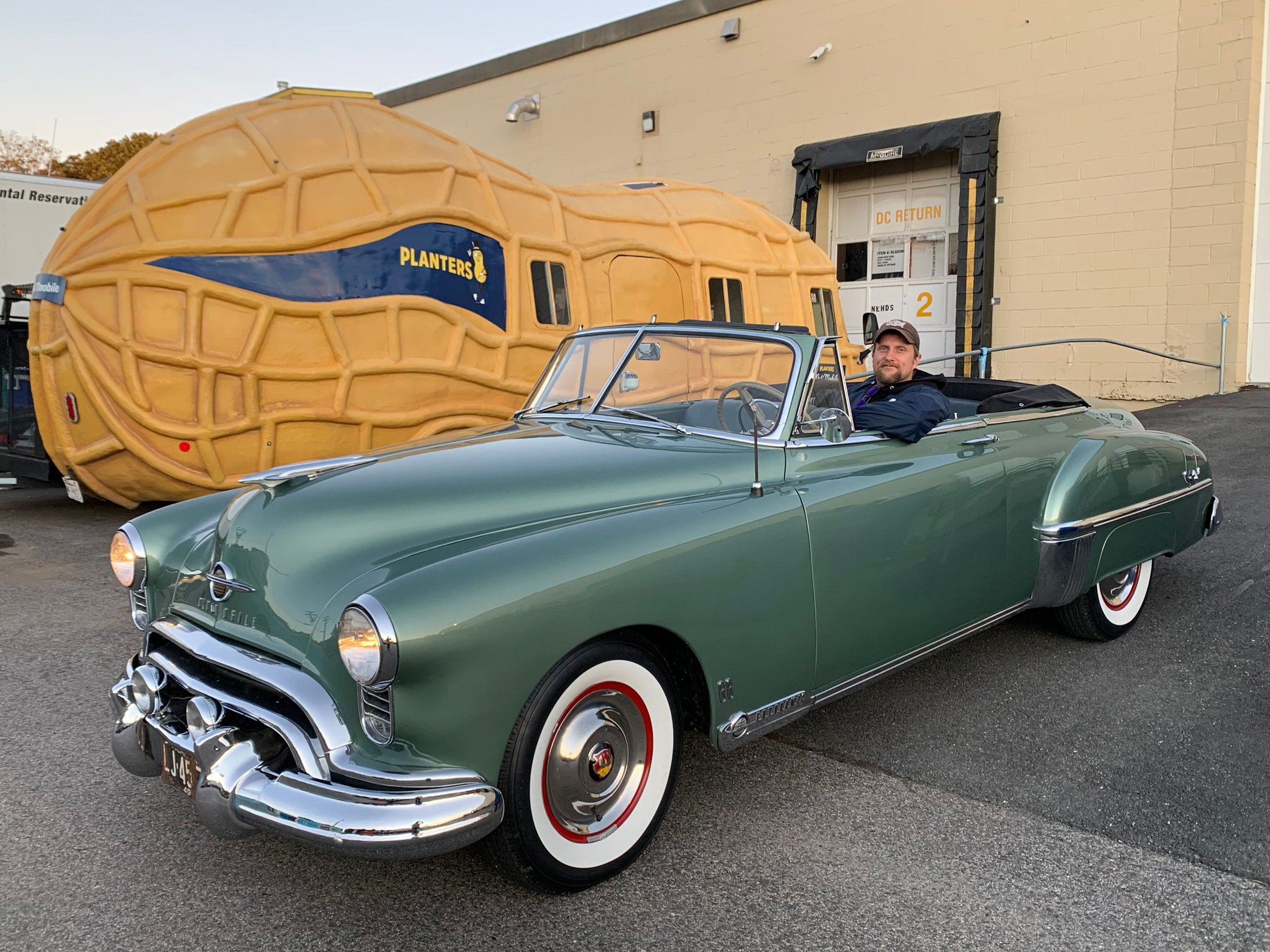

found Mr Peanut on the last adventure!! Posted the pic for fun.

¡Lo me gusta! 😎 Every time I see this 49 I like it more!
