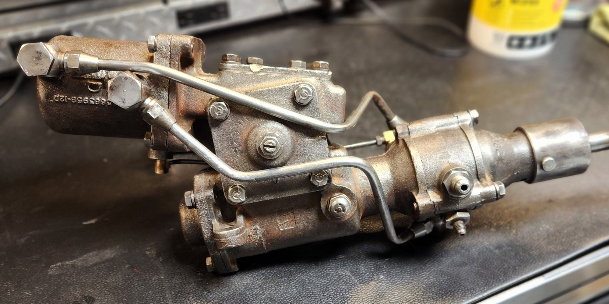

Mine is a 1955 power steering gearbox. What do I use to fill it? I just rebuilt the seals and need to fill it, it's empty.

Not the power steering pump and hydraulic system. the actual gearbox itself.

Hi Charlie, so yes it absolutely does. ATF and gear oil are separate and must not be cross-contaminated. The manual says fill gearbox with oil.
fill plug is right there. The control valve to the right is sealed off with orings and seals. Same with the power cylinder on the left. The pump, power cylinder, control valve and lines have ATF in them. The gearbox needs lube. I am leaning towards NLGI 0 or Corn Head Lube.

I see that this is different than the power steering gears used from the late fifties up that I am familiar with.
What does the service manual say about the lube to use?
What is "Corn Head Lube"?

They say its got the consistency of apple sauce. NLGI 0 flows more than a NLGI 2. Its like if you mixed chassis grease and 90W oil. I ordered a couple of tubes, it's what I came up with in my research. The service manual says on page 5-26, step 26, "Fill steering gear HOUSING with steering gear lubricant and install filler plug."

Topped it off a couple of times after I drove it, seems perfect, gearbox feels smooth. Now I have an extra tube of this that will sit in my garage until I die, LOL.
