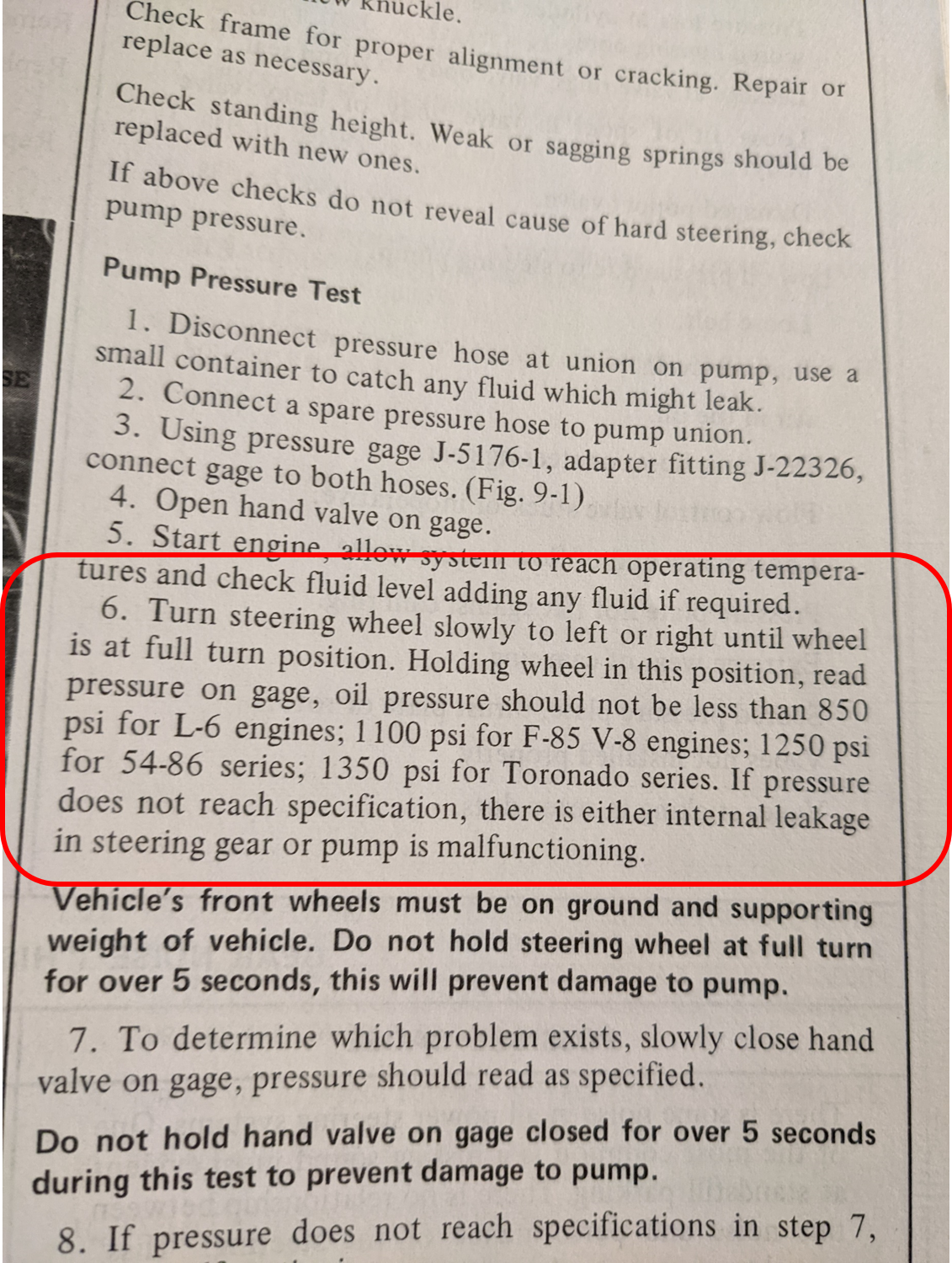

Can anyone tell me how much pressure is in the power steering system on a 1971 Cutlass? Thanks
Right there in your Chassis Service Manual.

Thanks Joe, maybe I should be looking for a service manual.
