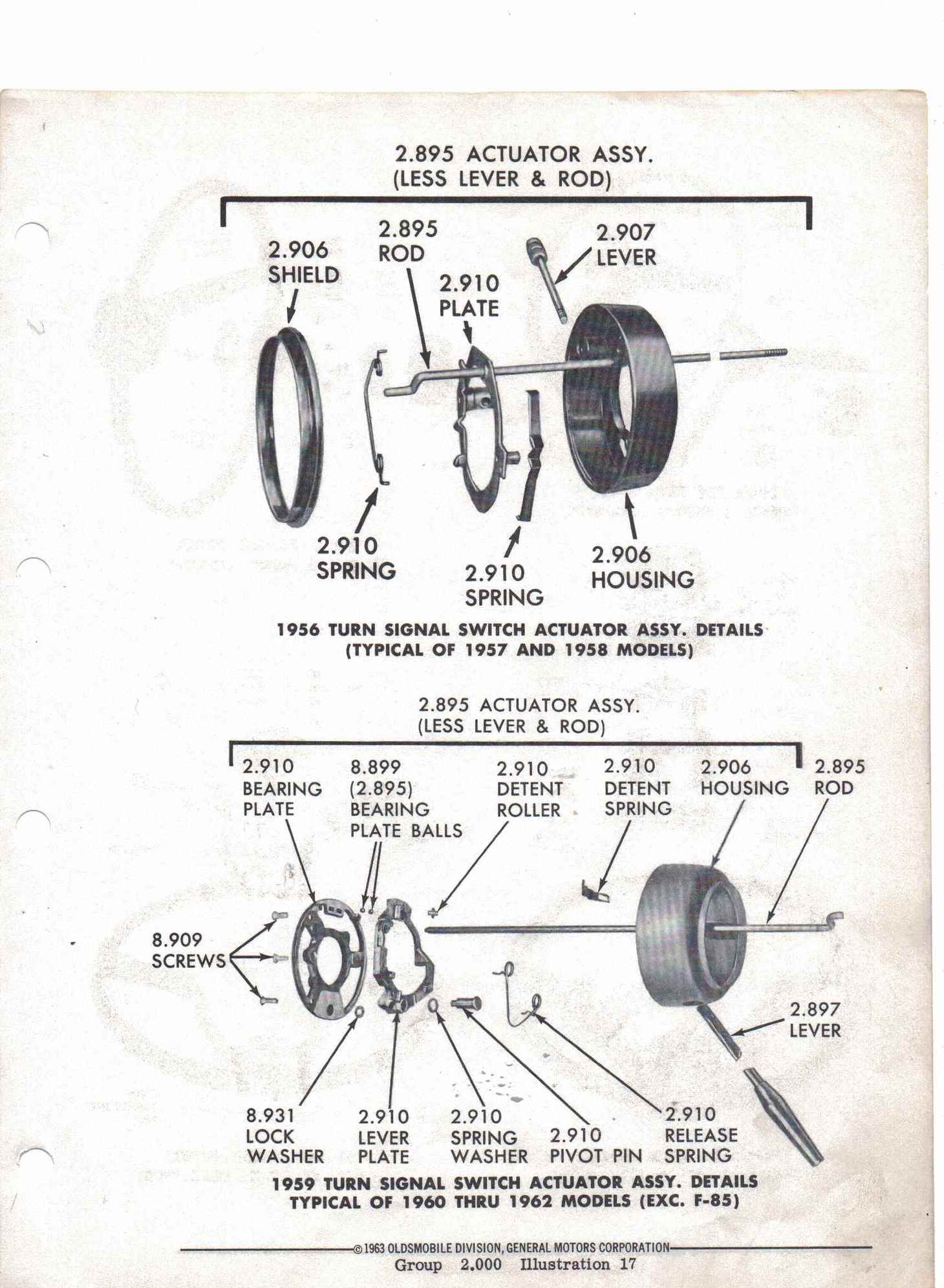

Turn signals were first offered on Oldsmobiles in 1941 as an option.
They did not offer a self cancelling feature until 1949.
In 1951 they became standard.
In the 1957 model a pin is pressed in the bottom of the steering wheel hub .
This trips the mechanism in the turn signal actuator.
This is an illustration of the actuator:

Thanks for that!
At least I know I’m not chasing something that doesn’t exist.

Thanks Mark.
Because I knew what to look for, I was able to find the roll pin that goes into the back of the steering wheel hub. It was the only thing left in a bag labeled Steering Mast.
That’s what happens when 6 years go by between tear down and reassembly. I remember thinking “I wonder what this is for?” At least I didn’t throw it away…
