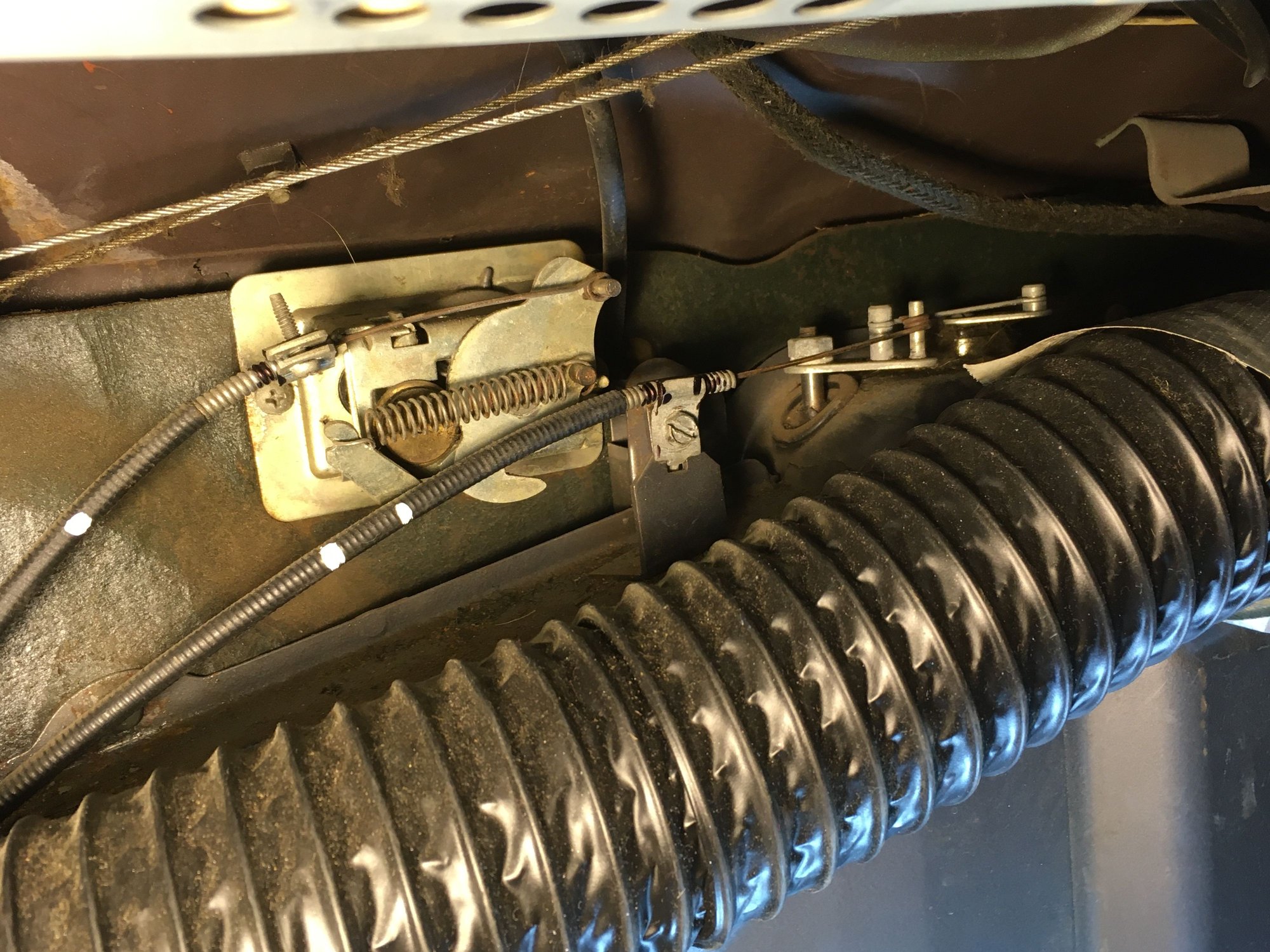

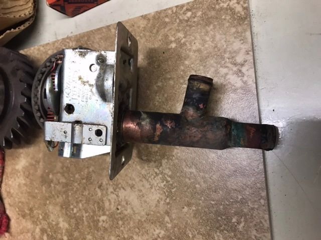

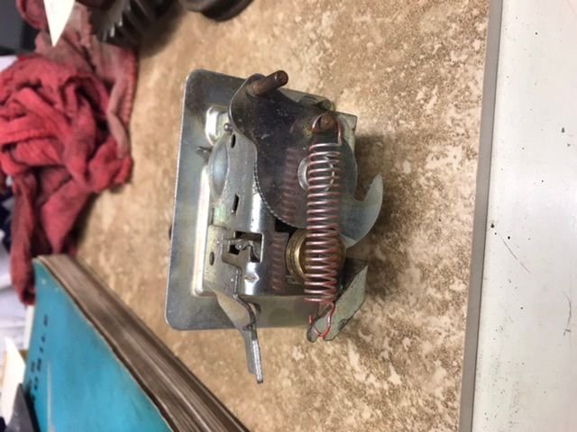

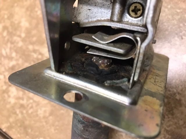

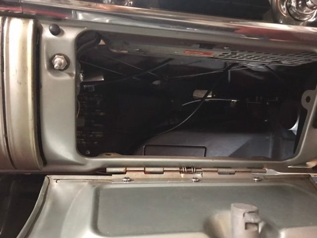

My grandson and I took the control valve out today and I took a few pictures. On my 55 the easiest way to access and remove it was to remove the glove box liner and defrost hose which were both pretty easy to do. I cut the hoses off the engine side and removed two screws that hold split cover plate on firewall. I disconnected the cable from heat control and two Phillips head screws that hold the switch on back side. My nine year old grandson did much of it at my direction. The seal on the valve looks like the problem as the switch appears to be in pretty good condition overall. I was looking at the rebuilt switch from Fusick that includes a $150 core charge but found what appears to be a nicely refurbished one on eBay for $135 shipped. Seller name is delcojoe. I can get $25 back if I send the core but I would like to refurbish it myself if possible and have a spare. This information and photos may help someone in the future.

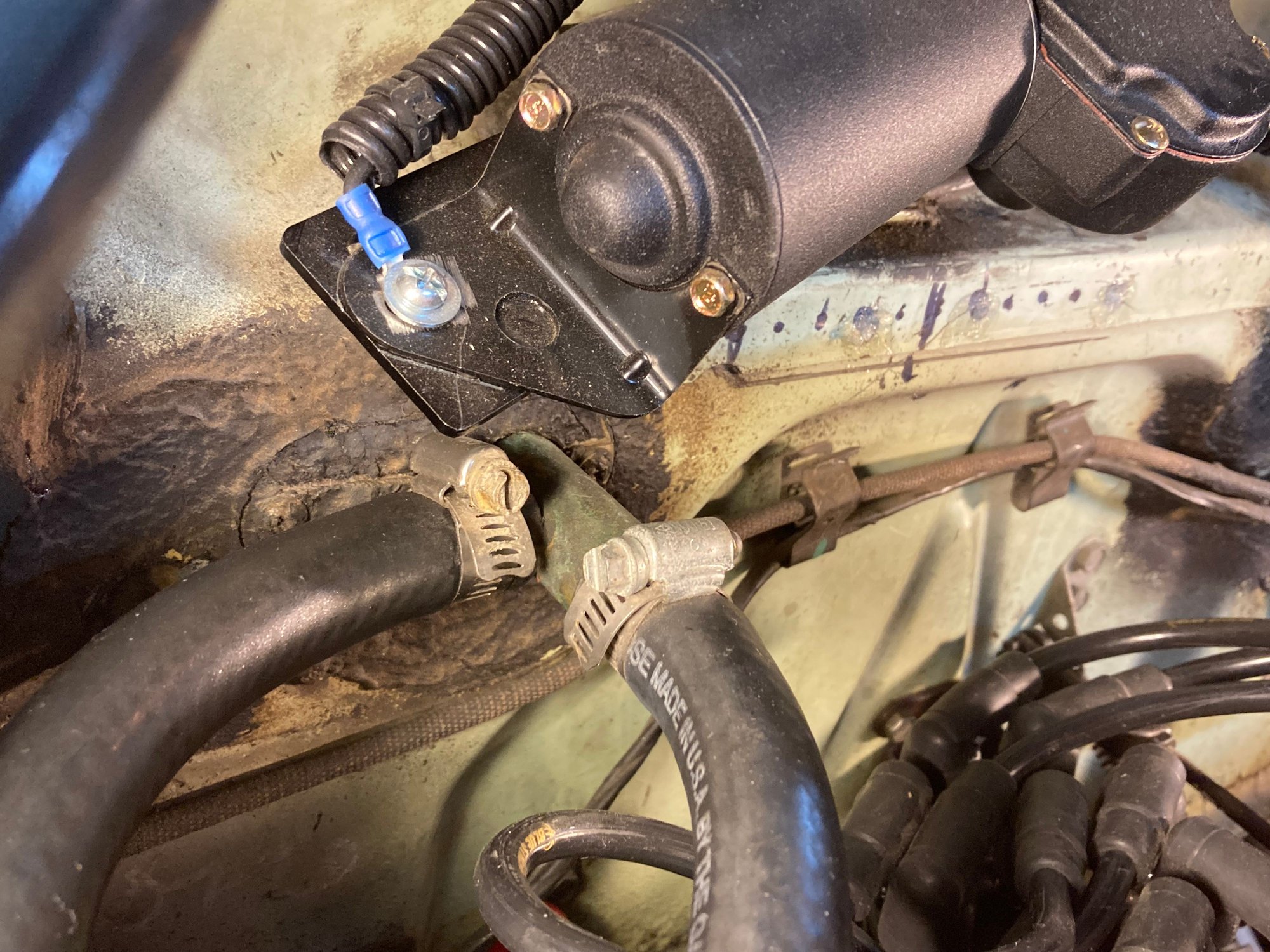

Hey guys, I putting a ranco valve back in my '55 that was removed and retrofitted prior to my ownership. I bought the one from delcojoe on ebay, nice piece by the way! On the firewall side, was there a plate or cover? If someone can post of pic of the firewall side of their ranco (heater) valve. Thank you.

If I remember correctly, the valve is inserted from Passenger side of firewall and attached on that side. On the engine side of firewall there does appear to be a somewhat oval plate attached to the firewall

Thank you for pictures, that helps! I contacted delcojoe on ebay and he said he has the cover plate for the firewall and it just going to send me one, so that's nice!
