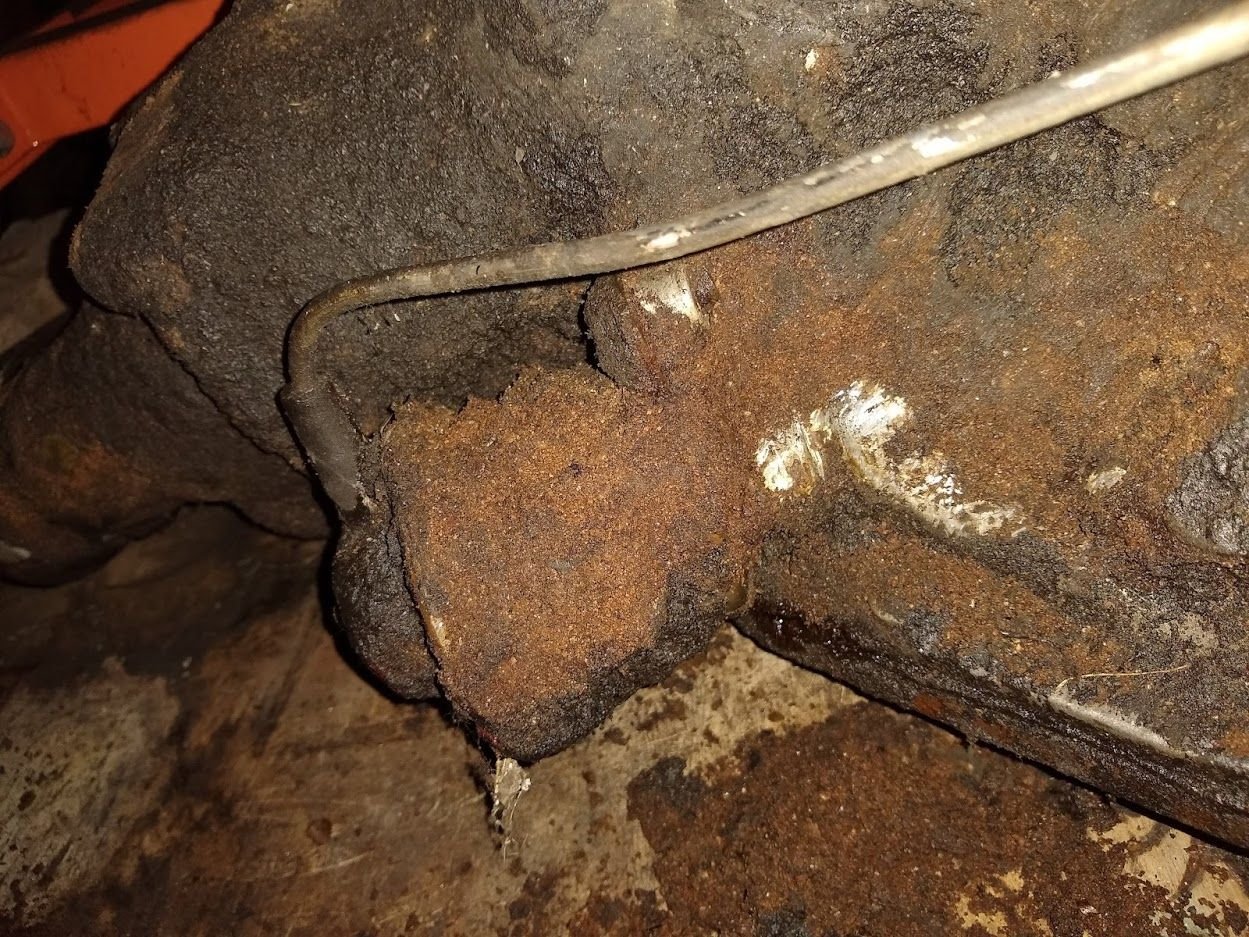

OK, I've been around cars all my life, worked at auto parts stores in high school/college, and have rebuilt the TH350 in my car, but I have no idea what that part is.
Ill get a dirty picture of the trans in my garage. Back in a jiffy
Old May 20, 2020 | 03:33 PM
Louise72's Avatar
Joined: Sep 2015
Posts: 16
Hmmm.
Not sure if this will work...
In the picture you'll see the vacuum line going into a small domed piece, that is the pressure modulator. What broke on mine is literally in the middle of the picture (slightly up from center).
The threaded cast on the bell housing was broken, causing the 'fork' piece to fall off - causing the modulator to pop out and dump all my trans fluid.
The only picture that is mine is the first, other two were found on random google search.
Per the trans shop, not that uncommon to happen.
old dusty from 72
this is what its supposed to look like fork piece and bolt
this is the new bracket that utilizes the lower right tail shaft bolt to hold that sucker in
