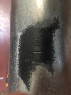

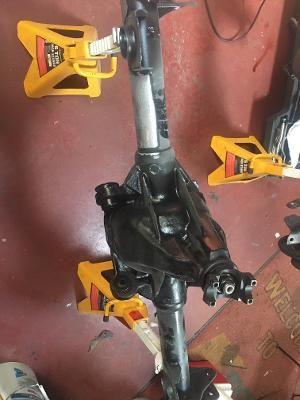

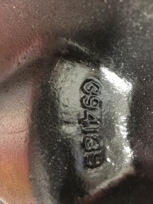

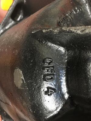

I bought this rear off the internet for a 70 W-30 restoration project Never took it out of the crate only checked the TM axle code. After 3 years I was prepping to install and noticed the casting number on the center section didn't
seem right nor the date code. Could anyone shed light on the de-coding for me.

It’s definitely not a 1970 O-Type.
That’s the same casting number as my 1968 TL code O-Type, which is a 3.42 open HD with 31 spline axle shafts.

From Supercars Unlimited page:"There are three basic 12 bolt "O" Axle housings. The 1967 through 1969 housing was used for all models except wagons. The original part number for this housing is 230727 and will have the casting number 39413 or 394139. This same housing was also used for the 1967-1968 models with 3.42 through 5.00 gears, but because these models used larger carrier bearings, the housings were machined accordingly and therefore required a different part number. The part number for the 1967-1968 3.42-5.00 housings is 320575.
In 1970, due to the axle bearing design change, the housing part number 231000 was used for all models except wagons and of course the W-27 aluminum housing. The W-27 aluminum housing used the part number 231042. The casting number for the non W-27 housing is 402227. The casting number for the W-27 housing is 406784."
https://www.supercarsunlimited.com/i...id/diff_id.htm
The first picture (screw)334(screw) is the Julian date of casting for the particular model year. So 334th day of 1968 or 1969 .
