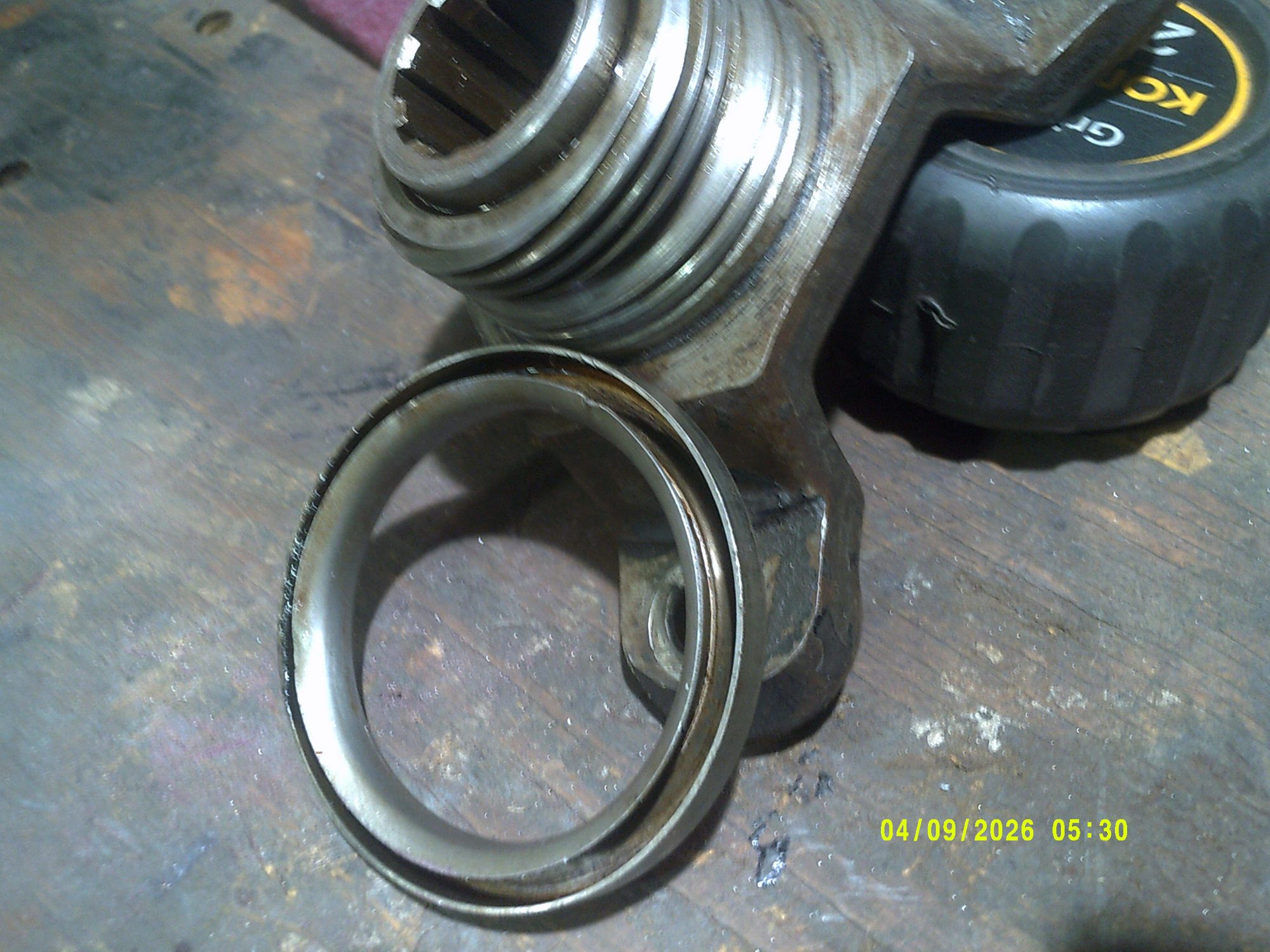

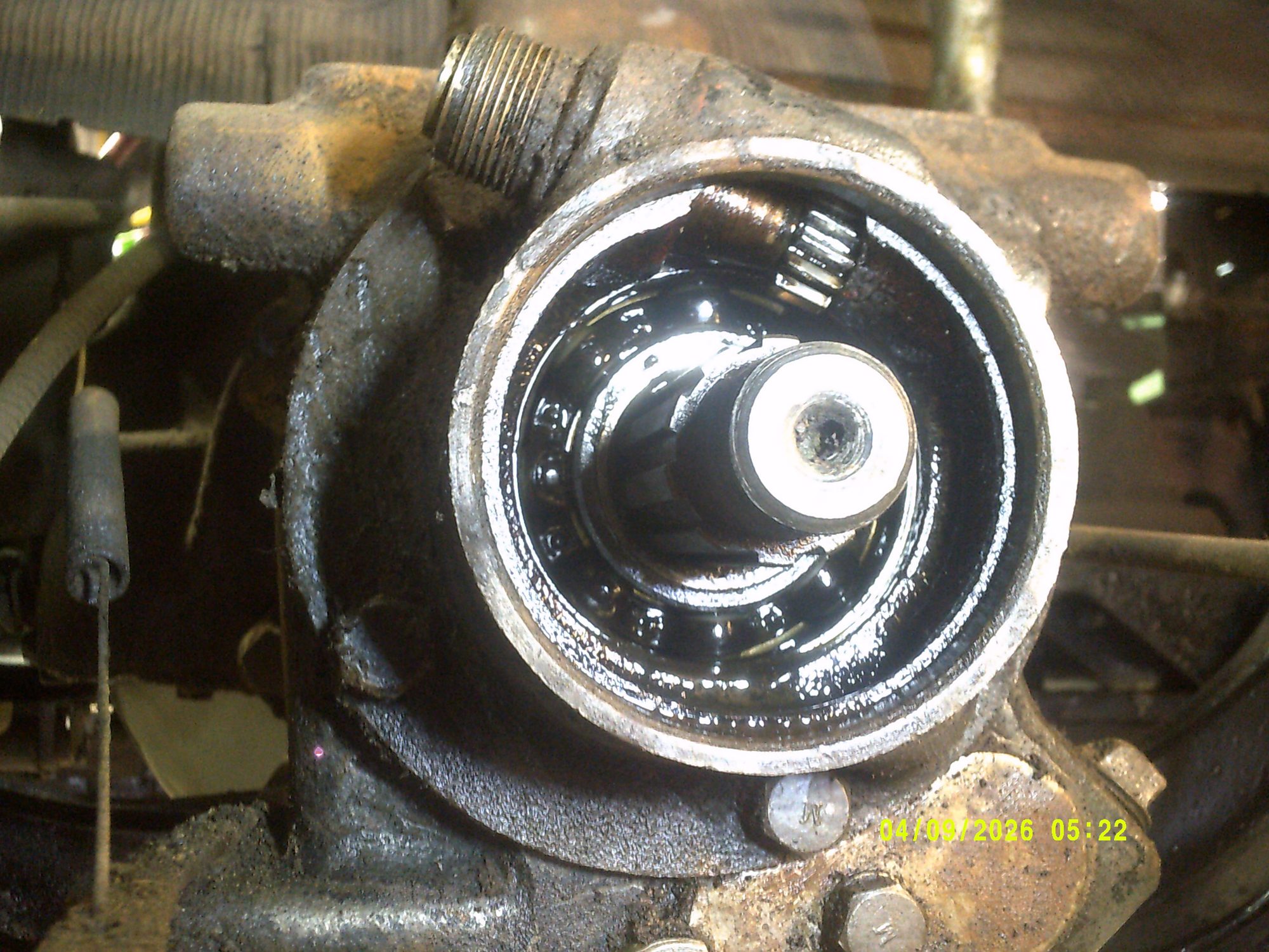

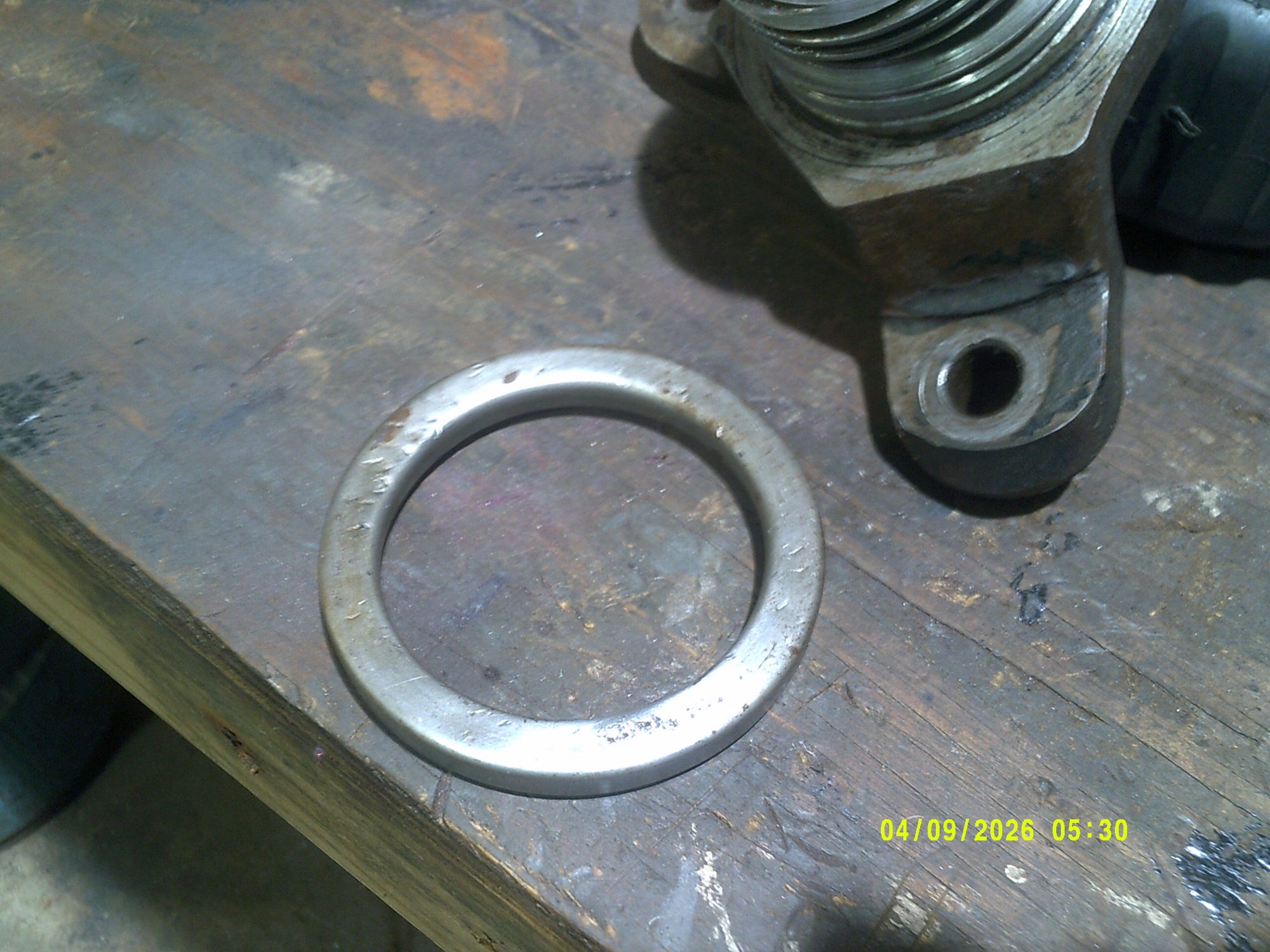

attached are some pics of what I have. The seal that's there is what I pulled out. From what I've learned, someone stuck something in that was close. Am trying to find a slinger & a pinion seal. So far, no luck. Anyone have a picture of the slinger & seal or an exploded view of the trans? Thanx
