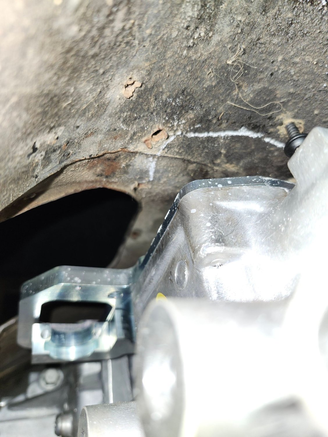

TKX install, for those that might be considering
I used Silver Sport and am overall satisfied with the kit. My car is original 4spd console so the TKX fit ok but I did have some interference at the rear top side of shifter cover plate. I had to cut about a 3" x 3" hole at this spot, bent the edges up and welded in new sheet metal patch to add about 1/4" clearance. My body mounts are original so maybe with new mounts it would have fit? New mounts would need to add around 3/8" lift to provide 1/4" clearance that silver sport recommended.
Also I needed to drill one set of holes and trim my cross member to fit the longer TKX. The cross member just contacted the trans at the front. Cross member has to move back, one factory hole on each side lined up but had to add one new hole on each side. Little difficult as the access holes on bottom of frame were not exactly below the new holes. Overall not bad spent one good weekend installing.
