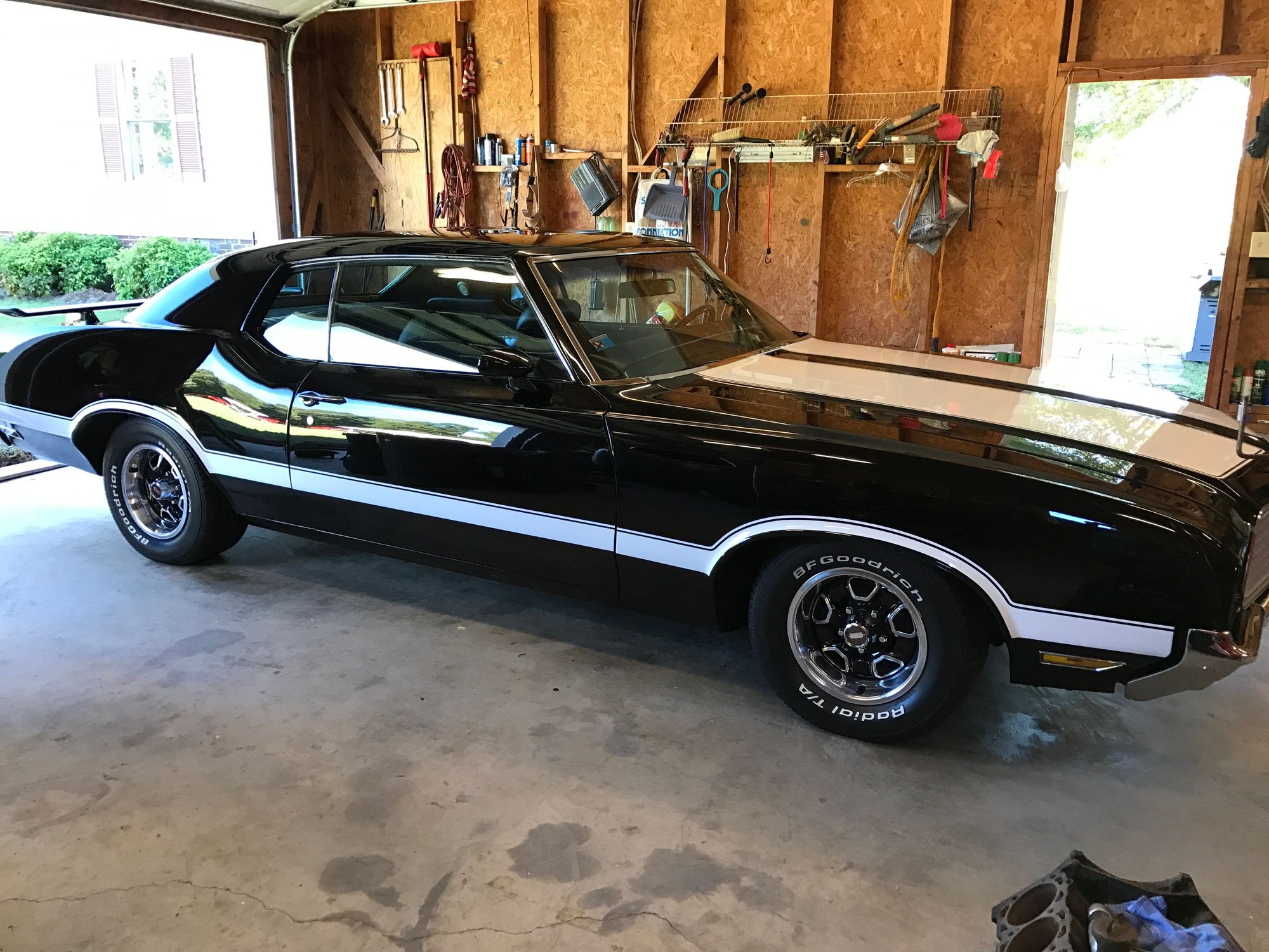

Sorry guys I made a mistake they are 245's not 225's but still only measure just a bit over 24 and 1/2 inches and only have 9000 miles on them
Old Dec 23, 2016 | 02:21 PM
oldman8187's Avatar
Joined: May 2013
Posts: 25
Wow. That tire would be small on a Civic. The original tires were about 26-26.5" in diameter. Even the BFG 245/60-14s are too small in my opinion. Yeah, the smaller diameter tire makes up for the Bonneville gearing a little, but there's WAAAAAY too much daylight in the wheel well in my opinion. I'd go with either 225/70-14s if you want to stay 14" or 255/60-15s if you get real wheels.
Sorry Joe I made a mistake they are 245's. Does not show it on my profile picture so I sent this picture it has been dropped 2" in front. Do you still think 15" tire will fit?
Old Dec 23, 2016 | 02:59 PM
The 255/60-15s will definitely fit in the rear. Probably not in the front with the drop. You could probably get away with 235/60-15s in the front.

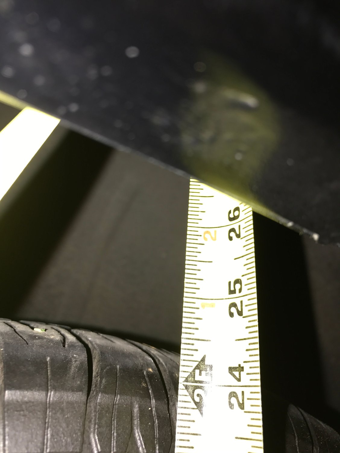

Old Dec 23, 2016 | 07:20 PM
oldman8187's Avatar
Joined: May 2013
Posts: 25
https//photos
Originally Posted by oldsmobiledave
Check your math sir. 245 60 14s are 25.6" tall.
https://tiresize.com/height-calculator/
here are a couple of pictures so if I am wrong the ruler is wrong
Old Dec 23, 2016 | 07:31 PM
oldman8187's Avatar
Joined: May 2013
Posts: 25
https//photos
Not trying to argue what size chart says they are I am just saying what size mine are. I looked at chart myself and mine are not as tall as chart says. The thing that gets me is they have very little wear on them only 9000 miles. I am now wondering how they could be that far off.
Old Dec 24, 2016 | 12:14 AM
svnt442's Avatar
Posts: 4,293
From: Palm Bay, FL
Because they are not measured with weight on them.
Thanks man didn't know you had to take them off car to measure height. Glad I posted photos so this could be cleared up. I was thinking for a while I got cheated on my tires. I am always ready to learn that is why I joined the forum.
