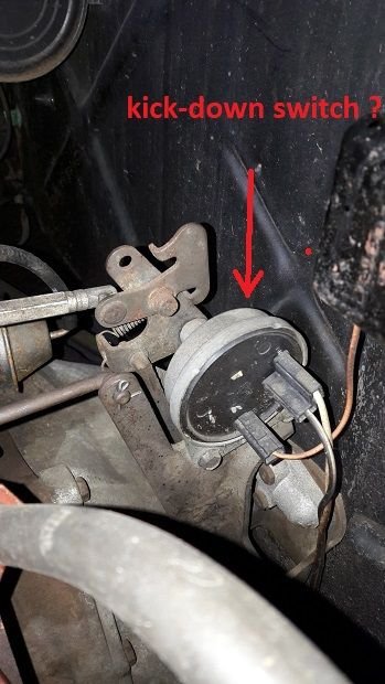

I need to check the vacuum line and modulator.
Is the vacuum correctly guided to the automatic transmission from manifold (see photo ) or should it be guided from the carburetor.
The second question has this TH400 gearbox in my Olds 88 1966 car a kick-down sensor (I found the sensor at the firewall and there are 2 cables leading to the gearbox) and can it be settings ?
Thanks for the advice .. sorry my english is bad :-) I am from Czech Republic Europe

Before you take anything apart check the function of that throttle position switch on the firewall. Unless the transmission was changed you have a variable stall torque converter (also known as switch pitch) that was used in the Oldsmobile TH400 for 1966 and 1967. The throttle switch on the firewall controls both the downshift function and the switch pitch function. The wires at the transmission connector provide 12V to downshift and 12V to switch into high stall depending on throttle position. It is possible that the contacts in the switch are malfunctioning or the solenoids in the transmission are not working properly. Either one could make your rpms high. It is easy to test the switch pitch wiring and functions (the solenoids make a click when energized). Testing can be done without running the engine and without taking anything apart. Do a search on "switch pitch" and read all about it. If you get the switch pitch running right it will help move that big car.

Dig around under my username and you’ll find some further instructions on the Switch Pitch / Kickdown switch for these cars.

Here are the instructions for adjusting the switch.
