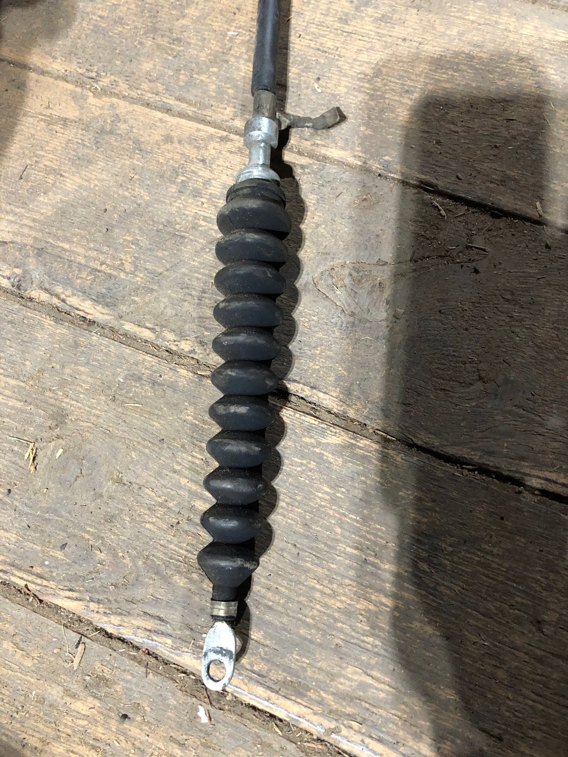

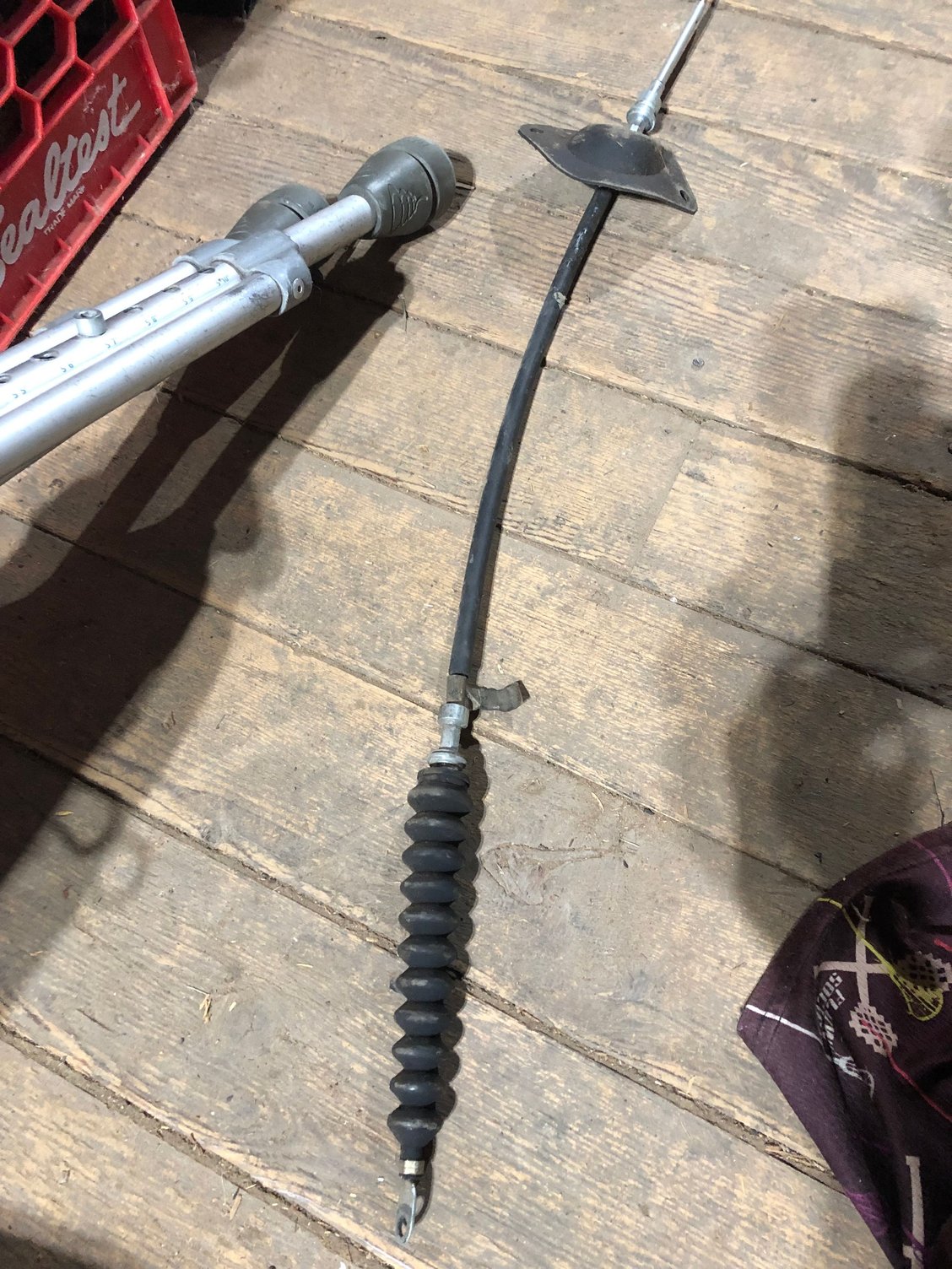

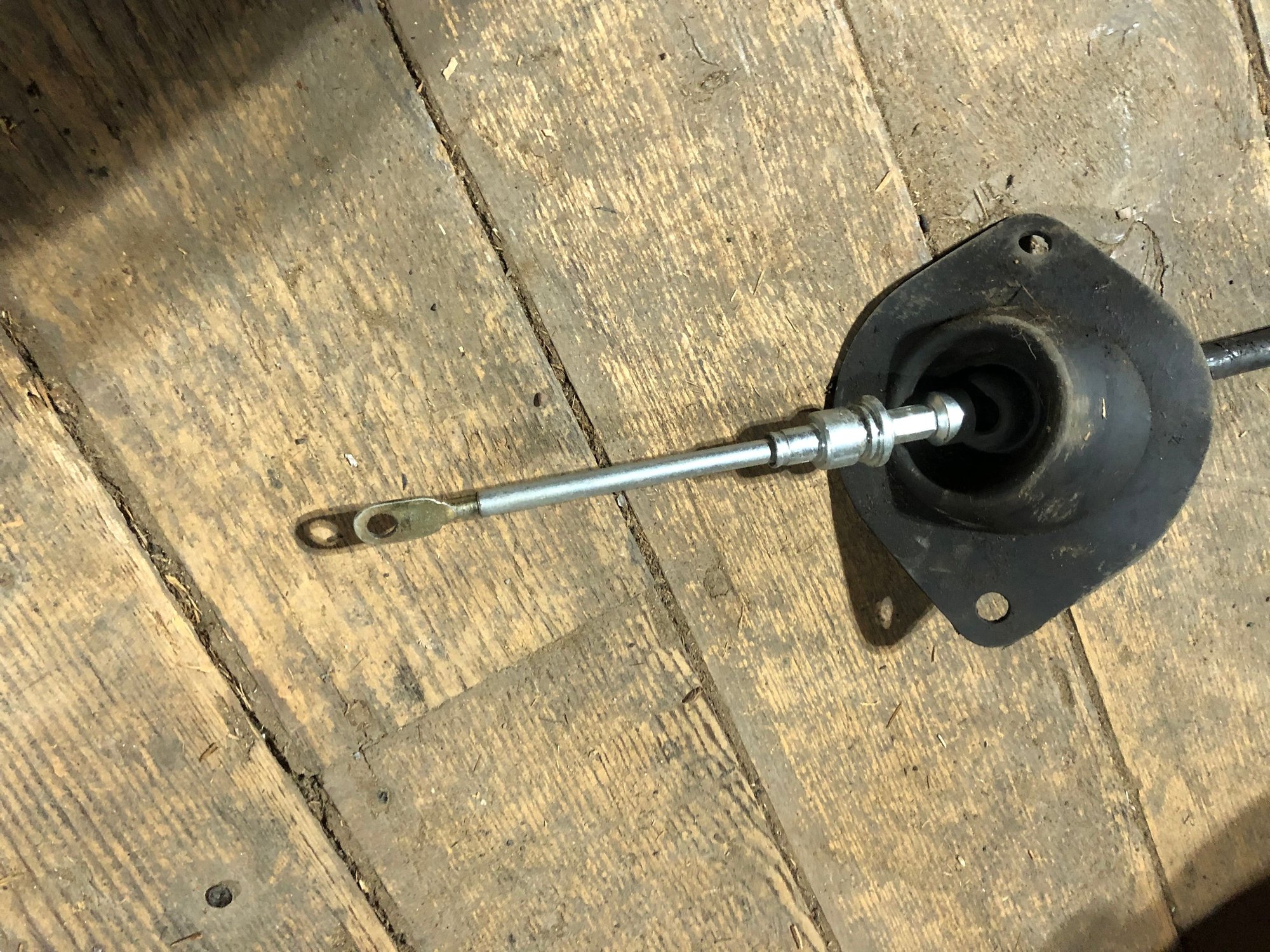

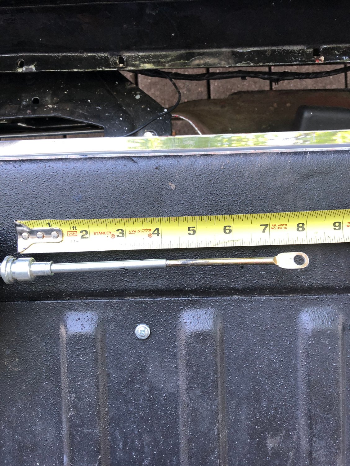

Shiftworks cable for a Dual Gate MIGHT help. I’m not sure if DG cable is different from std floor shift, or what the difference might be. You could compare what you have to this GM cable, reputed to be a DG cable.
There are scads of brackets, you might be able to find the right one for 200-4R, or some other that the holes can be slotted, or an adjustable version. I have a number of them kicking around but don’t know which, if any might be a winner.
If the cable shown might help you, or you want to gamble on a bracket assortment, PM me.
