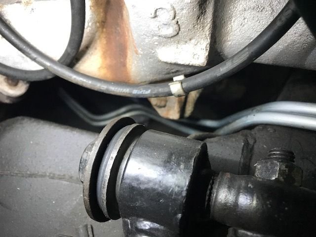

I'm trying to find pictures of the proper mounting locations for the transmission cooling lines in my 67 Cutlass, and I'm having no luck.
Does anyone have photos of the trans lines leading from the trans, under the engine, connecting to the radiator? Specifically, how are the lines attached to the oil pan? Is there a bracket?
Thanks... Paul

If I remember right there is a clip on the frame cross member above the engine mount pad that holds both lines.
Yep, and here is what it looks like.

Great photos, thanks!
It sounds like these should be routed away from the oil pan. With other GM models, the bracket is bolted directly to the oil pan, but that's not the case with our cars.
Does anyone have any photos of the proper routing of the lines? I'm trying to wiggle these into place, trying to avoid contacting the hot exhaust, etc... I'm guessing someone has a show car that has these routed correctly?
