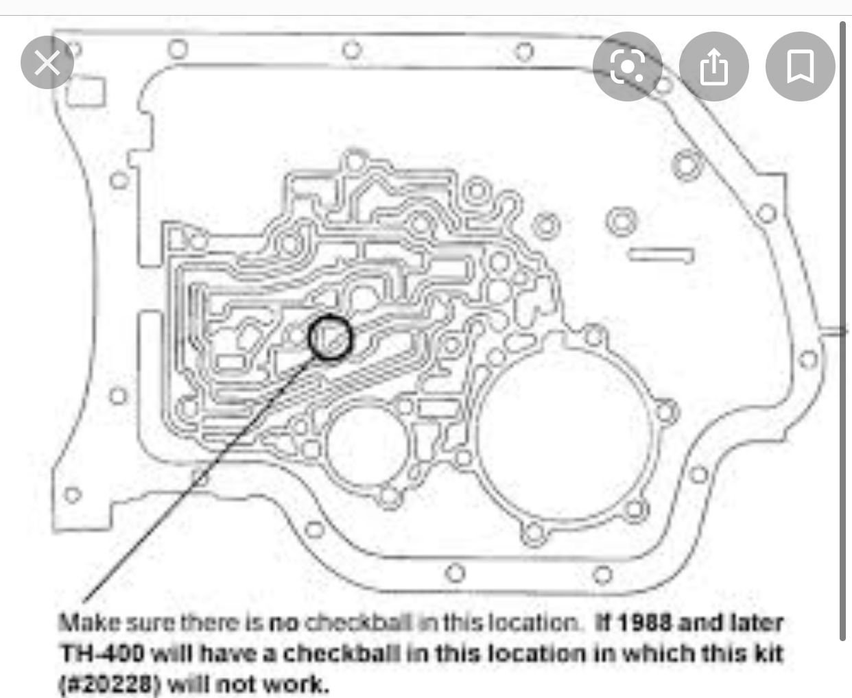

BTW, the 87 and up case added a 7th check ball and restriction to the rear servo feed, all to soften the reverse gear. To the best of my knowledge, every manufacturer designs a plate to work with every model year case.

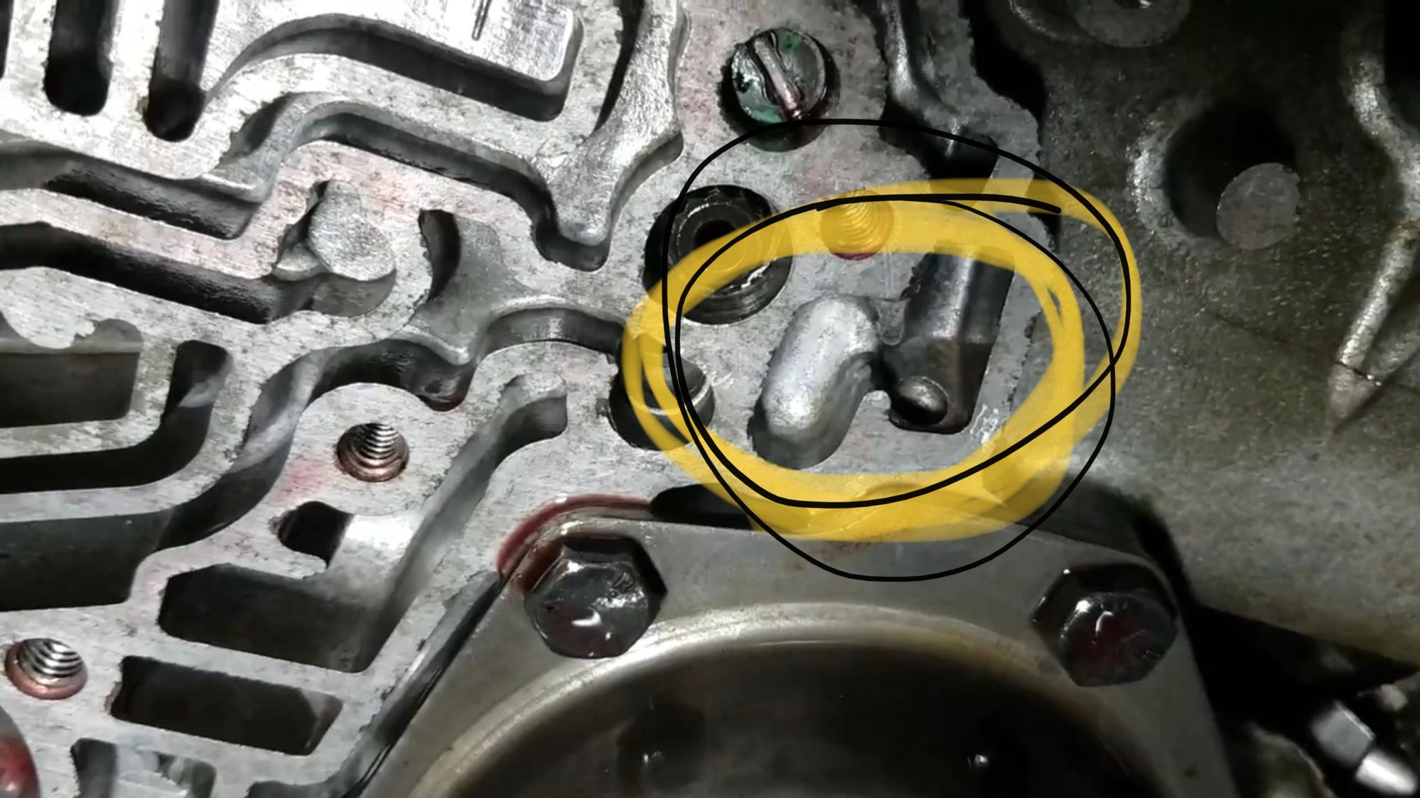

The hole circled is the feed hole for reverse. Be prepared for a potential oil bath, it can get messy.

I just looked up that part number valve body, that’s a forward pattern full manual. That changes some things. If this is a Oldsmobile transmission, you don’t need to worry about compatibility issues with a late model case and the 7th check ball. GM didn’t use the 400 trans behind anything but Chevy in 1987 (that I’m aware of).
i found a pic of a case with the 7th ball to help identify what you have.
