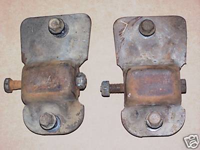

The 200-4R didn't exist in 1979. The only available transmissions were TH200, 250, or 350, all three speeds. The 200-4R crossmember is different and won't work with the TH350.
My question was, were on the frame did you bolt the Olds frame mounts, and are they oriented correctly (RH/LH)? There are a bazillion holes in the frame crossmember for engine pads. Olds mounts use the rearmost holes on the crossmember.
Where on the block did you bolt the motor mounts (which should be 2328s or equivalent)? There are three bolt holes on either side of the block for the motor mounts. You should be using the rear two of those three.
This is what your frame pads should look like. The should be stamped R and L.
This is how far back they should be on the crossmember.

I guess I’ll have to reposition the mounts mines are more the front 🤦🏾‍♂️🤦🏾‍♂️🤦🏾‍♂️ Thank you

Originally Posted by big reese
Is that’s how they need to be positioned on both sides??
Yes. The mounts are symmetrical on the block. The frame pads need to be symmetrical also.
