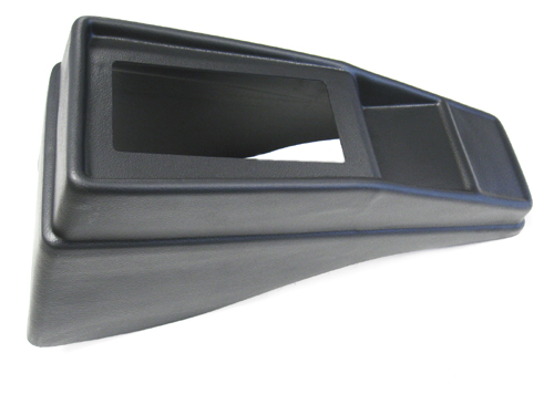

Just so we're clear, when I say "mini console", this is what I'm talking about. Note that it uses the rectangular top plate as used on the GTOs, not the 70-72 style top plate.
This is the console used in the 68-69 H/O. I'm not sure what other info you're looking for. The shifter bolts to the floor, the console bolts over the shifter with the top plate. If you are trying to modify the stock 67-69 console, there are no "directions" on how to do it, you need to use your fabrication skills.
