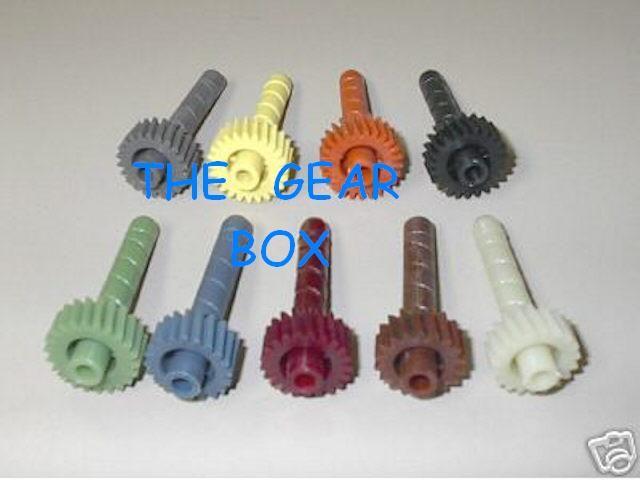

In my 67 Chassis manual, there is a section that shows different speedometer gearsets for the different ratio rear ends. Some of the drive gears (the one on the output shaft) in some sets have 17 teeth. I have never seen this drive gear in any Muncie and I have been into lots of them. Is this a special trans or just a hard to find gear?
Old Jan 28, 2016 | 11:46 AM
Posts: 50,802
Now you have. It's the purple one. $11 from this vendor.
