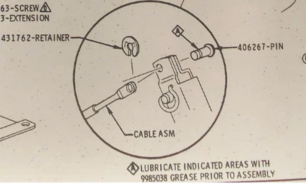

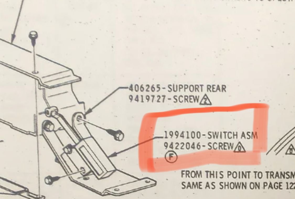

Ok I’m trying to round up the last parts needed to swap my 1970 442 console shift automatic to Hurst Dual Gate. I need the screws to fasten the shifter to the car, the screws to attach the neutral safety switch bracket to the shifter mounting bracket, the pin and clip to attach the neutral safety switch to the shifter and the pin and clip to attach the shifter cable to the shifter. Any help would be greatly appreciated.

You can get the pin here. As far as the NSS, I took the easy way out when I converted to dual gate and I used the column mounted setup that column shift and 71-72 console shifters used. I think you would need a different harness though.
