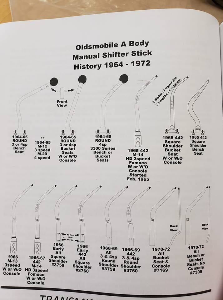

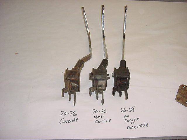

Shifter use:
End view of a 66-69 shifter. All 66-69 shifters are a straight handle. There is no difference for console vs non-console

Mike, I can't tell you how much I appreciate those pictures and images. That is a huge help. Thank you.
Mike
