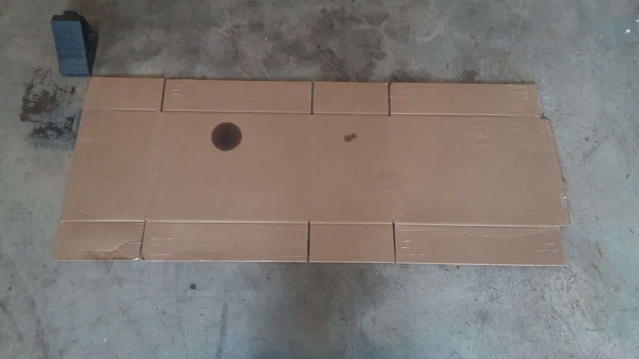

Here's a pic of fresh cardboard I had under the 96 for 1 night after having it towed. This could be the side pan leak the transaxle had before I even drained the fluid and installed a transmission filter over a year ago.

That doesn't look like much fluid, maybe only a 1/2 tablespoon. Try it on that cardboard, you will be surprised at how little it takes to make a spot on cardboard. Have you checked your modular valve? It could be sucking fluid into the intake...Tedd

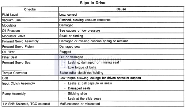

I checked my Oldsmobile service manual. The only other thing I might try to remedy this slipping is to replace the vacuum modulator. Unfortunately, the OE vacuum modulator doesn't have a ruptured diaphragm. I removed the vacuum line and there was no trace of ATF. Is it worth $30 to try one last thing to fix this transmission, or is it DEAD? 😵

I tested the OE vacuum modulator today instead of installing the parts store vacuum modulator. The OE vacuum modulator passed. 13 in. of vacuum at the modulator in DRIVE. Per page 7A-23 of the service manual that passes. Also, the vacuum modulator was able to hold 23 in. of vacuum for over 30 seconds and it didn't even leak down to 22 in.
I find myself searching for 4t60e shift kits, but I should probably avoid throwing parts at the problem.

If I want to continue to troubleshoot the problem I should stick to the diagnostic chart I posted above. It's straight from the service manual.
I should probably hook up my scan tool to see if it gives me additional information.
