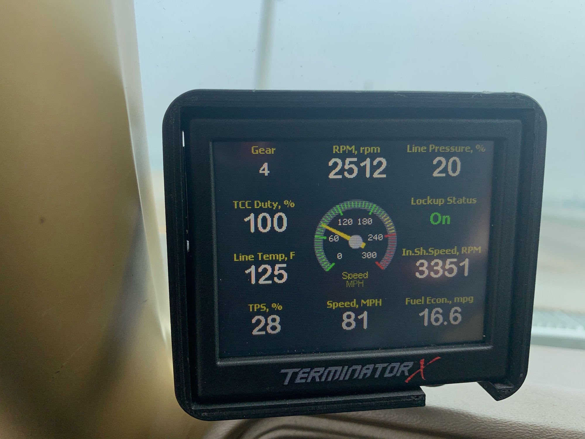

You don't need to spend a lot of money for an 4l80e for it to live behind 500-ish hp big block. I bought mine on Craigslist for $1k, it was rebuilt by GM and it came with the receipt. There are plenty of cheaper options.
I bought a CK master re calibration kit for $200 that my friend installed. with CK mods, it's supposed to be good for 750hp in a car (not a heavy truck) according to Chris himself. I also used banjo fittings and AN lines for cooling. My car dynoed 438rwhp, 416rwtq.
Expensive part is a quality converter, I paid almost $1k for Circle D 245mm. 80mph at 2500 rpm, car is a joy to drive now.

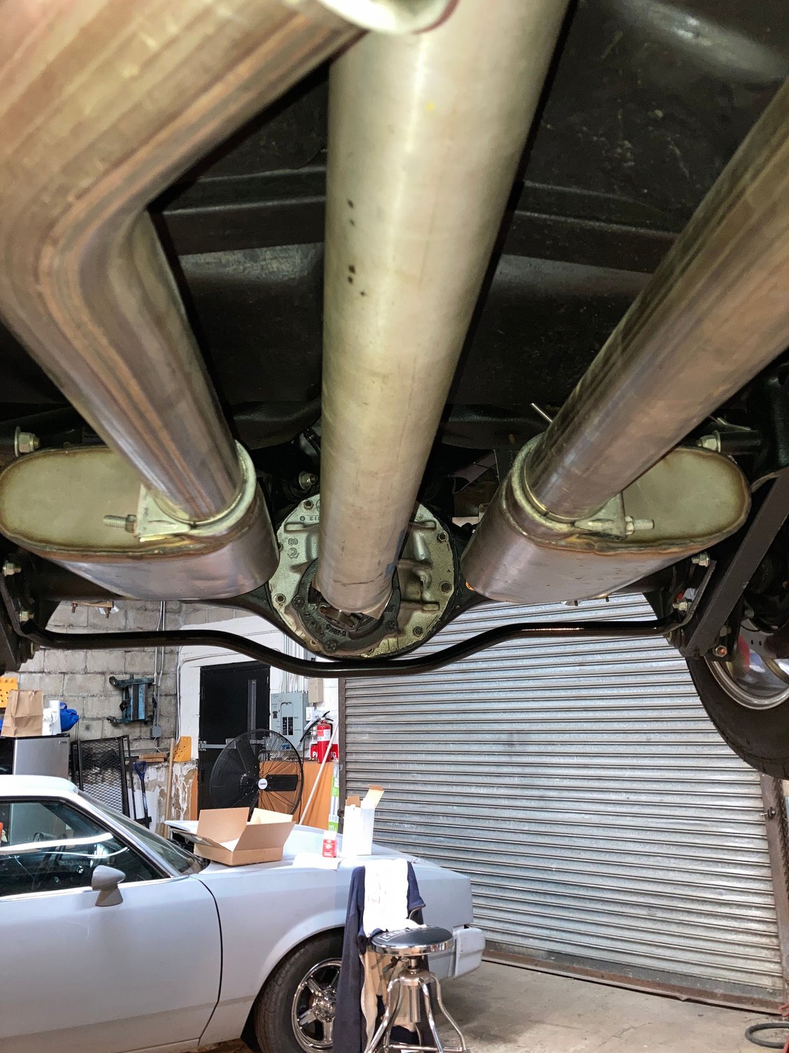

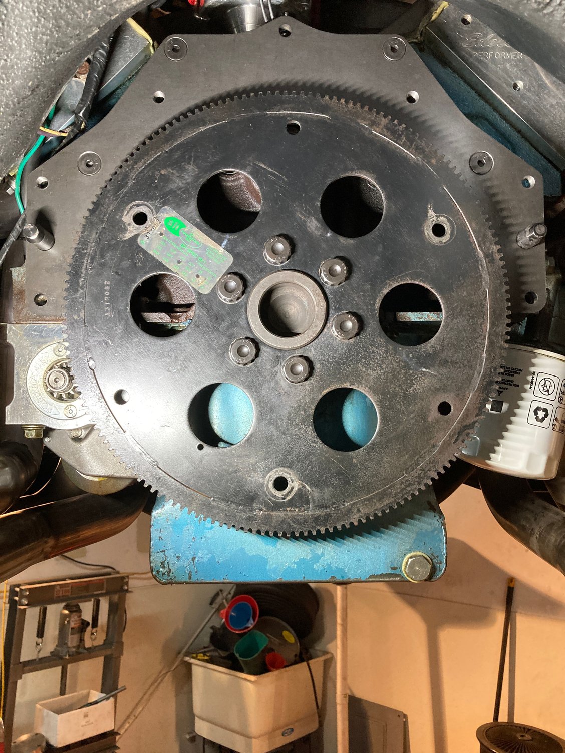

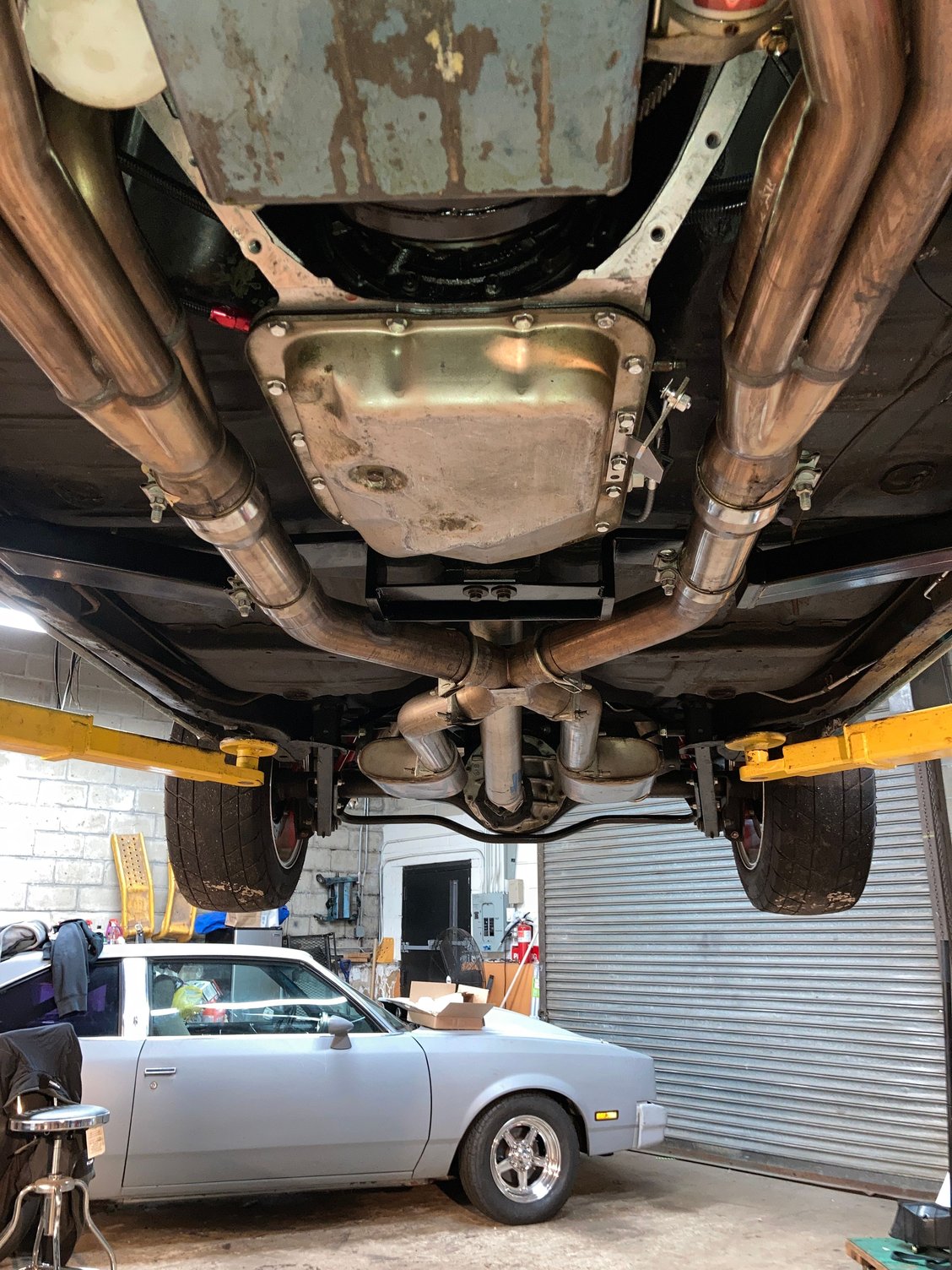

4L80E install in 1970 442
My son and I just completed the installation of a 4L80E in my 70 442. No extraordinary complications. you need an adapter plate, A new or fabricated cross member, a shortened driveshaft, a trans controller, and shifter conversion. I did a big write up on the Restomod Oldsmobiles web site on Facebook. I love it. I have 4.10 gears and cruising rpm at 60 mph dropped to 2,200 rpm in lock up from about 3,000 with the TH400! My write up on Restomod tells what I used, gives the costs, I used a CK rebuilt trans. Contact me if you want more details.
