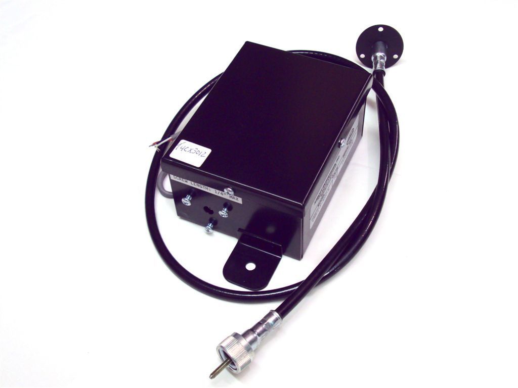

You can also get conversion boxes that take the VSS signal and use it to drive an electric motor to turn the speedo cable.
