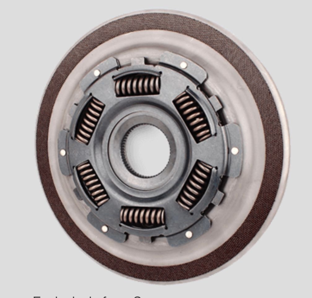

Posts: 6,104
The lock up clutch is maybe an inch wide, and just a little smaller than the converter diameter. Just not a lot of surface area for the clutch friction to grab. The converters that are designed to be locked under WOT are much bigger, and use multiple discs
You can see the converter clutch friction ring here.

Zoiks! I see now why a vacuum switch would be critical on a torquey engine. Good info, thanks.
