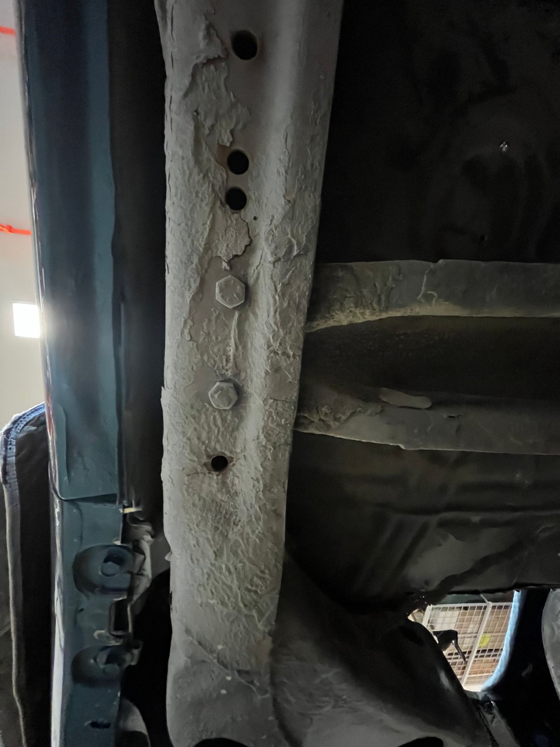

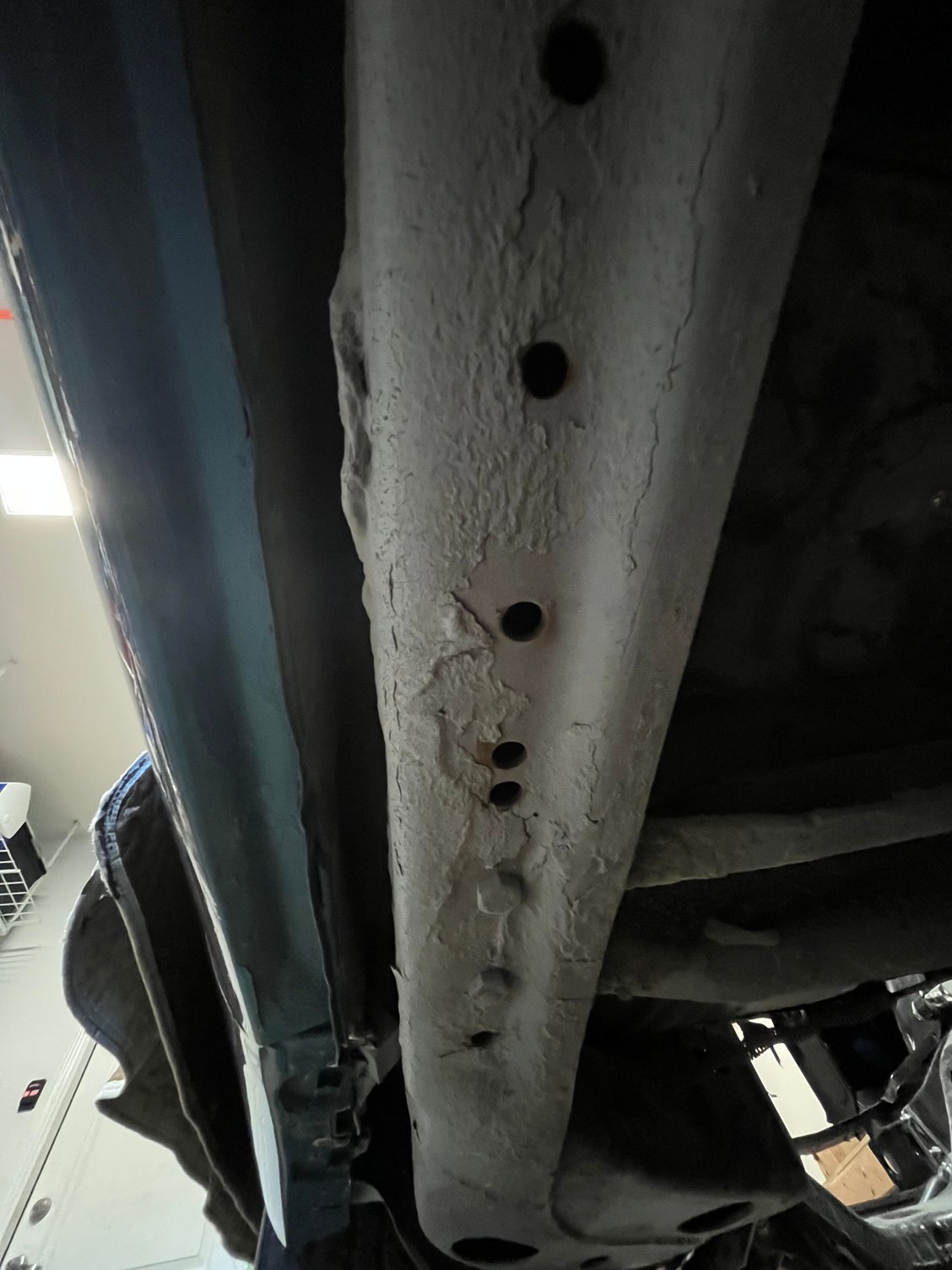

I’m in the process of converting my 66 442 from an automatic to a four speed . As I read through this old thread, it appears that I can use the original crossmember, repositioning it to fit the four speed , and re- drill new holes in the frame (it’s not a boxed frame).
There are currently 8 holes drilled in the frame, one forward of the existing crossmember and 4 holes aft. I would assume since it appears the 4 speed is shorter, I would have to move the crossmember forward toward the front to make it work. I know that this will also affect the e-brake cable and driveshaft length, things that are easily remedied.
Am I on the right track here?
Tom

Assuming your automatic is the original two speed Jetaway, a Muncie is exactly the same length. The crossmember does not need to move and the e-brake cables do not need to change. I'm sure you are aware of the pilot bearing problem with an AT crank.

Joe, thanks for the crossmember info. That’s great!
I was aware of the A/T crank bushing issue. Had the machine shop bore it to specs and install a brass pilot bushing for the M20 4 speed.
Appreciate the help!
