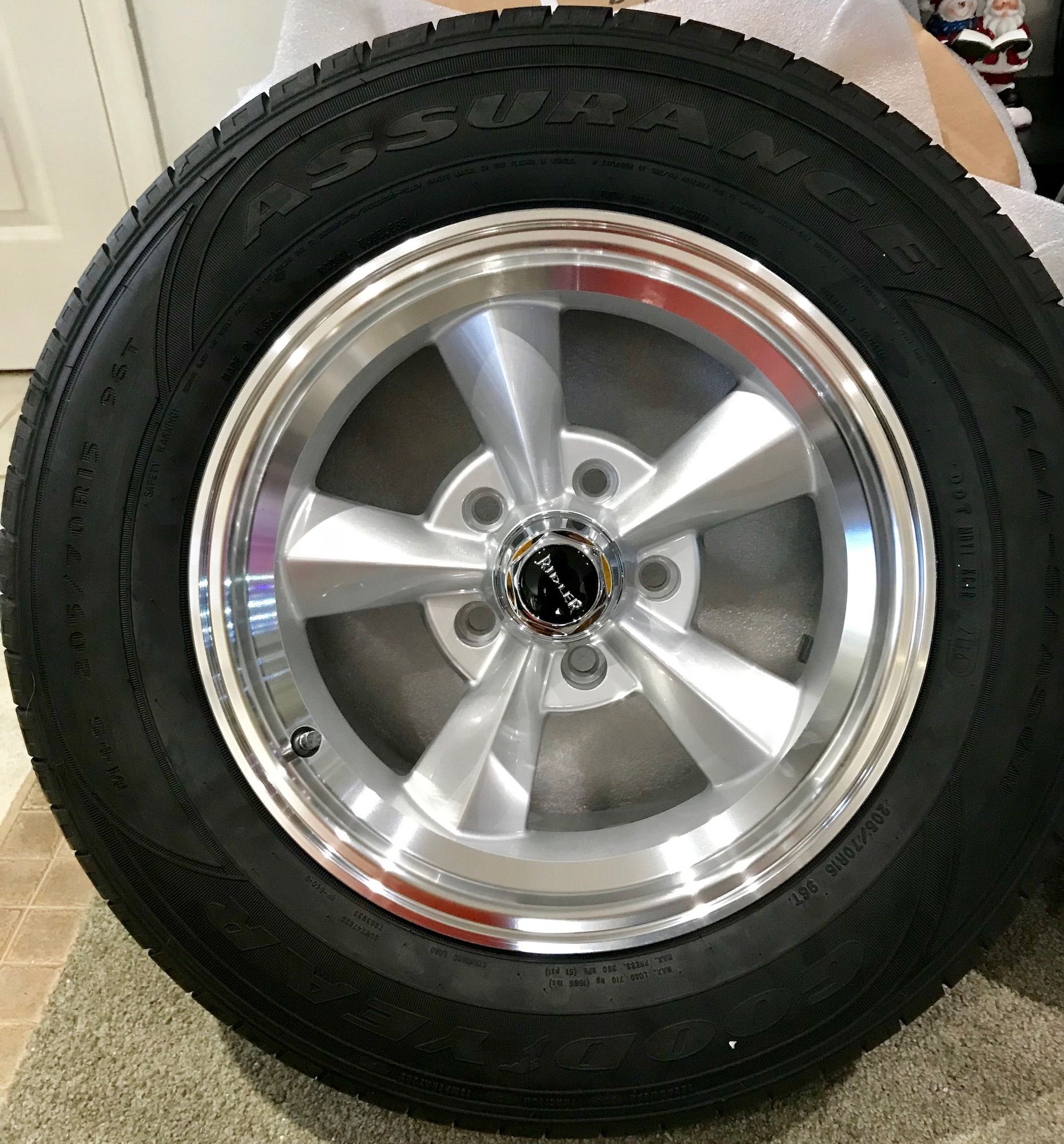

That site reference may be for factory but my wheels are aftermarket. 15x7 wheels with Goodyear 205/70-15’s. I may have to experiment with another size.

Nice wheels. Had to look them up. Never heard of them.
Thanks. They were a good option for my budget. I’m thinking of switching from the Goodyear 205-70-15 to a BF or Cooper 245-60-15. Maybe that and some different shock absorbers will balance it out a bit.

Nice looking wheels

Nice looking wheels
did the springs up front go into the upper and lower pocket correctly
Thanks, appreciate it. Yes the springs are installed correctly.
