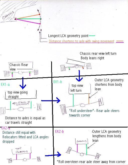

It doesn’t always hurt handling. Whether it helps, hurts, or has negligle affect on a car’s cornering capability is vehicle and setup specific. Many cars, such as the S197 Mustang benefits from using LCA relocation brackets to change rear LCA geometry and increase anti-squat in road racing applications.
Lowering the axle side of the rear lower control arm (LCA) increases anti-squat. But, this change in geometry can also induce unacceptable roll center oversteer. Roll center oversteer is the rear end literally adding steering angle via the rear axle.
In this instance, the LCA is pointed at a downward agle toward the axle. As the loaded / outside control arm swings up, it pushes the axle towards the rear of the car. The unloaded / inside LCA swings down which in turn pulls that side of the axle towards the front of the car. So, now the axle is crabbed in a way that generates oversteer. And, it’s not consistent. The harder you corner, the more the suspension compresses, and you get more and more roll center oversteer.
I am not in anyway saying if it would help or hurt an A-body’s cornering capability. I’ve not installed, tested, or raced an A-body with LCA brackets. I did forget to mention that LCA brackets accomplish the same thing as the SSM LCAs mentioned above.
My gut tells me that at stock rear suspension heights, you would likely induce unwanted roll center oversteer. My Olds is lowered 1.5” - 2” in the rear and the LCAs still have a slight downward angle and positive anti-squat. I suspect using LCAs at stock height would introduce LCA angles that hurt cornering capability.
