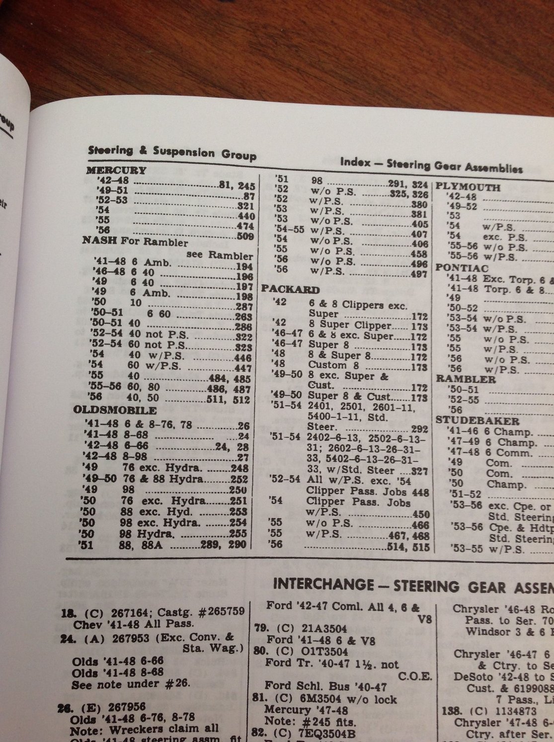

I cant seem to find a steering box, steering column, pitman arm. The car was originally an automatic. What are my alternatives? What other steering options are there for my car? Anything a bit more easily accessible? I don't have an interchange manual but am thinking I might need one soon. Thanks.
Jesse
1953 Olds Super 88 4 door sedan
Old Dec 10, 2021 | 06:36 PM
2blu442's Avatar
Joined: Jun 2006
Posts: 520
I've got a 1955 parts car with a power steering column/box if it would interchange. Joe's reference shows the pitman arm interchanging, but I don't know if the box/column does too.
John
Old Jan 12, 2022 | 11:25 AM
425HP409's Avatar
Restorer
Posts: 159
From: Frisco Texas
Hollander shows the 53 to be all by itself
and the 54-55 the same, with them not interchanging with any other cars.
