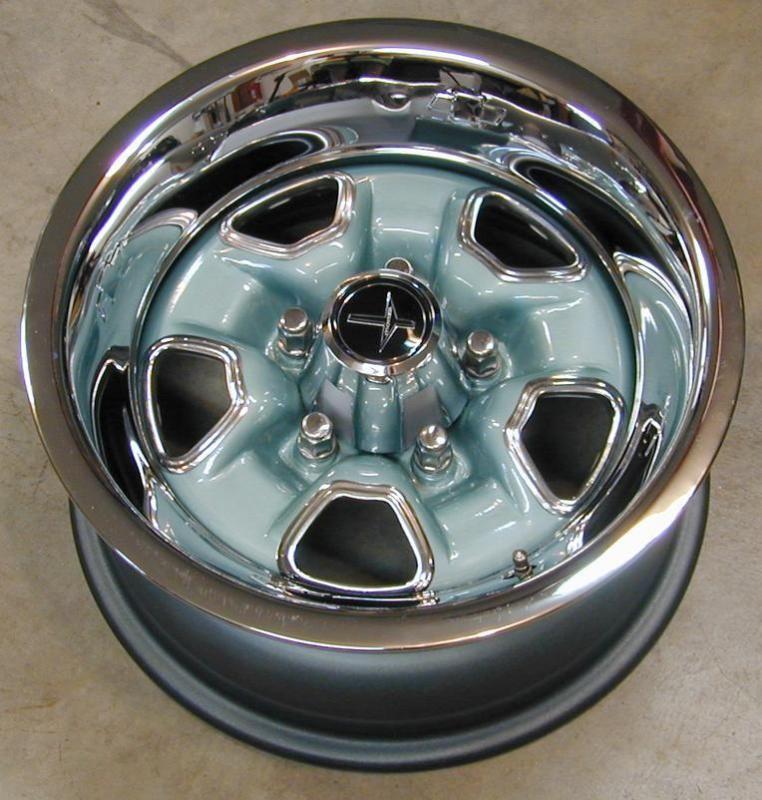

* The car is run daily, never being idle at any time except in winter for inclement weather. The chrome valve stems are fine and the rubber is not cracked. I have the 2" TR418C which are hard to find. I do no know if the Slime 1 1/4" shall suffice. i have the rally wheels, what do you think: fit or not? Thanks very much for your input. Most likely, I'll have the new tires balanced and mounted, drive the car and see if any alignment is required.

* Thank you very much for the accurate information as to the sleeve (chrome) being 'slipped off'. In fact, the sleeve does slip off which I was not aware of. I did not pay too much attention to that aspect, then decided to see if the chrome sleeves do slip off. "They do", as you stated. Would you go with the 1 1/4" Slime or the 2" stems? I have the Rally SS III wheels with 2 1/2 inch trim rings.

I am not sure about the exact length, but I like mine to be long enough to get an air chuck onto the end without touching (potentially scratching) the trim ring and short enough so it's not sticking way out.

*Thanks much, agree with you. I'll stay with the 2".
