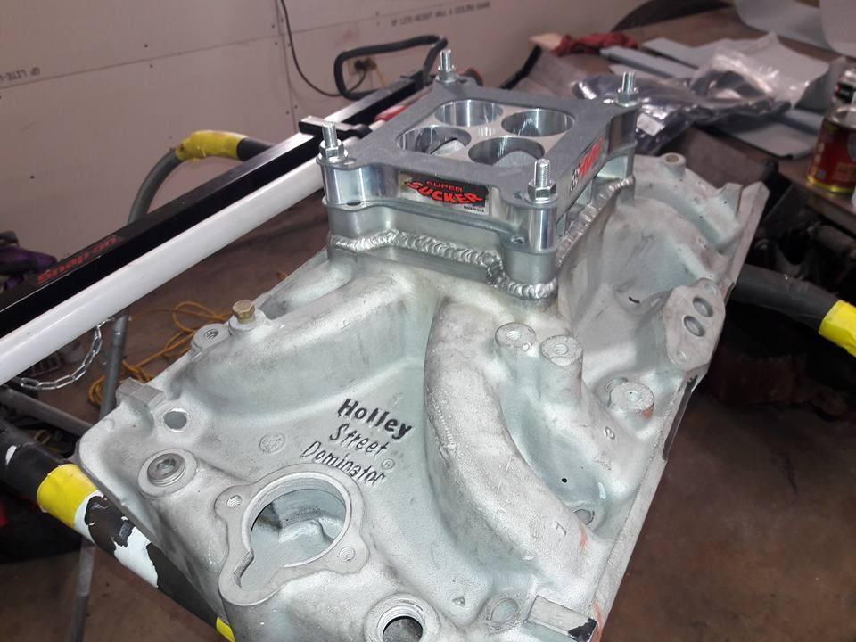

Sometimes the cam is out of spec, other times the timing set is. Both cases are why a motor needs degreeing. Copper does your SD have a spacer welded on and then another 4 hole spacer added on? That serious solid cam should help get you in the 11's.

I see it in the bottom pic, you running EGR with that.

This chain is off i degreed a cam before using it and same deal. I never used the chain. The egr ports have plugs in them. A spacer was welded in and its no longer a spreadbore flange. The flange was milled then spacer was welded and filled the rest up.
