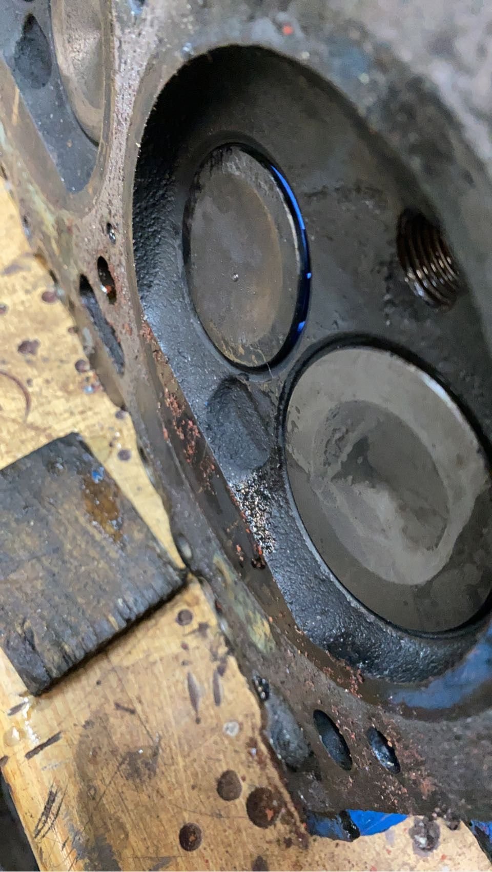

Solved!
For any future readers, the problem was not the pushrod. However, the exhaust valve had gotten slightly bent by the stem letting air out in what sounded like a blowoff valve. Spotted it by taking the head of and shining a light into the exhaust just to see it between the valve and valve seat.
