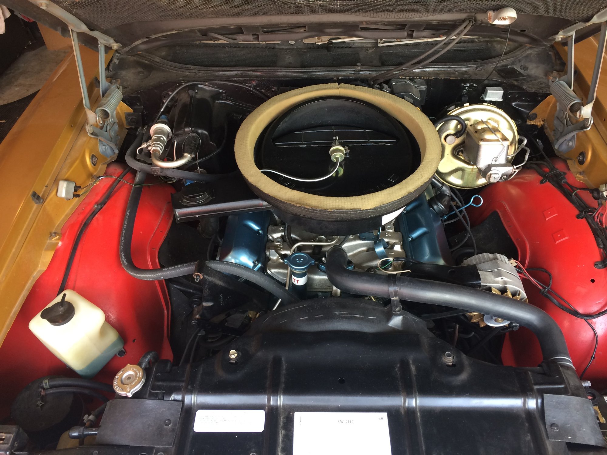

Here"s picture of original 70 hinges.

Nicely done and have fun.
