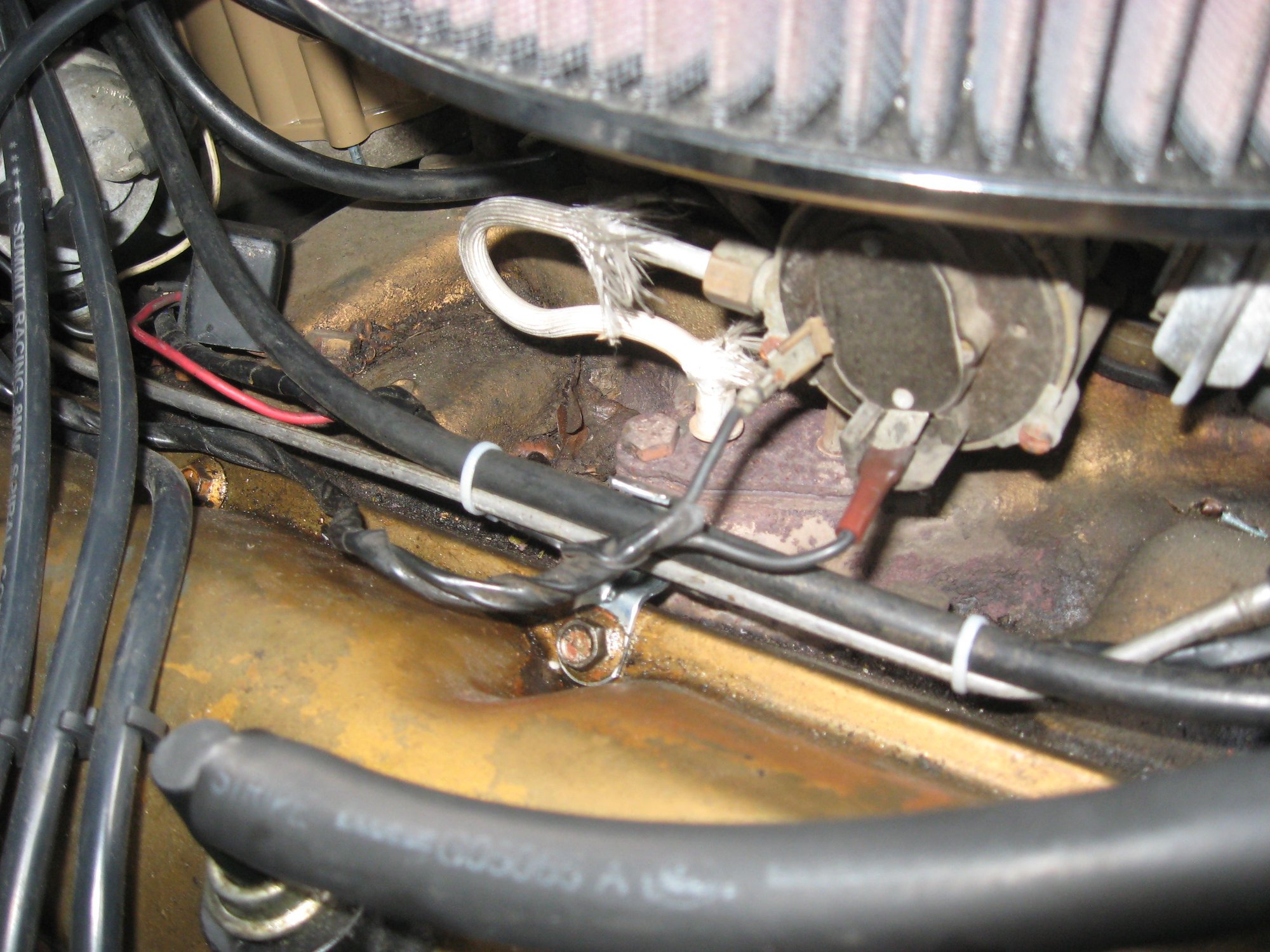

Thank you for all the advice. I did notice something funny from what's been said. My '71 has a 4 bbl w/ both hot air tubes & electric choke. Is this original? It seems strange. Car started perfectly this AM w/ temps at 40 deg. Ran OK warming up & seemed to drop out of fast idle. So far so good. I adjusted the choke cover slightly clockwise/leaner. The choke closes completely when cold. Then I also checked warm & it was fully open Electric choke is connected to an ignition circuit & works correctly.. Car get stored all winter so it should be OK for occasional starts. After it cools down I'm going to clean it really well again w/ carb cleaner. Hopefully it will continue to work.

Well I have to say that in 50 years of wrenching on old cars that is the first time I have seen electric and hot air both connected. Gotta ponder that for a while to determine if it would cause any issues or just be totally redundant.

Nope, not factory, a conversion. No Olds V8 came from the factory with an electric choke. The two terminal electric choke is a dead giveaway for aftermarket.

Would guess the small vacuum port in carb for the hot air choke would cause the electric to not work properly. So one would be fighting the other.
Is there a gasket between electric choke and choke housing? If so, electric wouldnt be grounded and not work.

Second wire is a ground wire. It definitely opens w/ ign. on. Originally they had it wired to the washer circuit up by the pump for positive. I didn't like that because accy. would cause choke to work. I rewired it so choke is on an ign. only circuit. It grounds through that funny little black box in the photo. It used to have several wires on it. Now none are left any more, only the one going to choke coil (ground). I think that box was something to do w/ pollution vacuum circuit originally. That stuff is gone now. Dist. vacuum hooks directly to carb, ported vacuum. Car started & drove well today, so am tempted to leave it alone for now. I'll try to get those numbers.

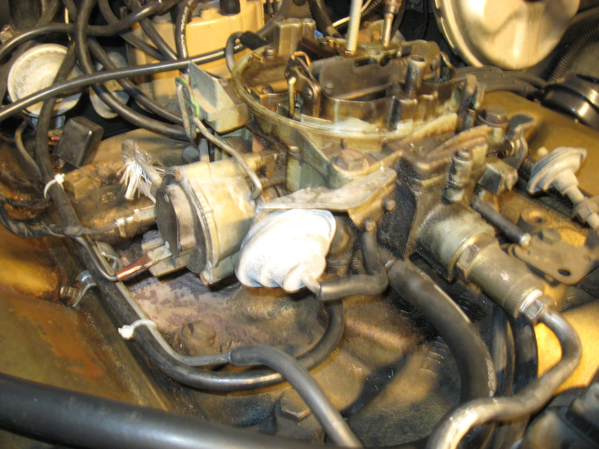

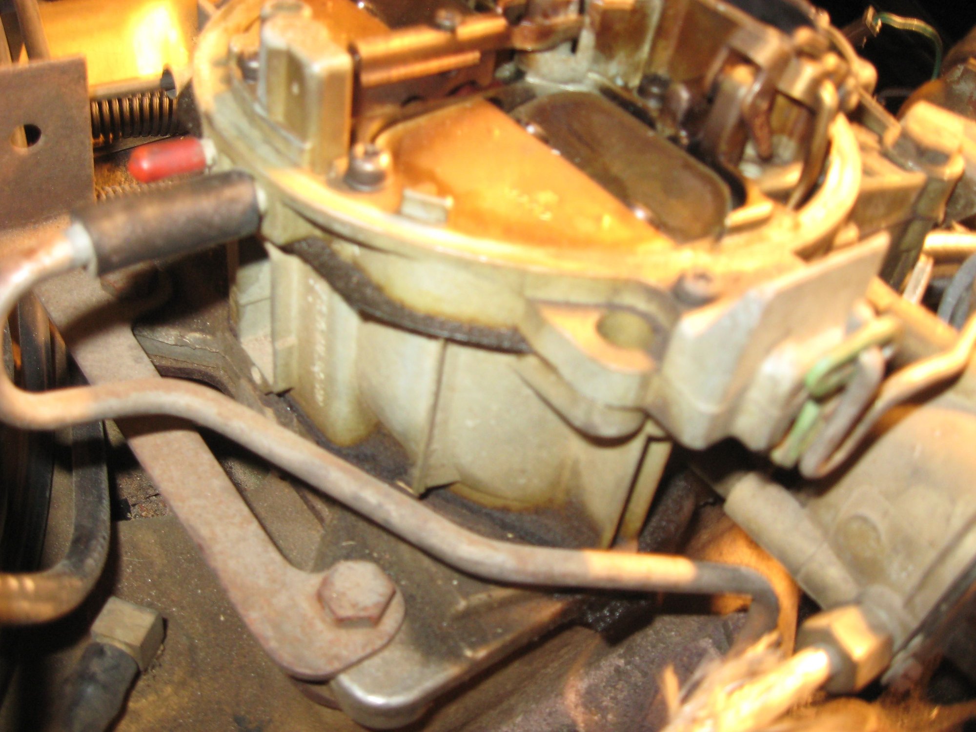

Here is the mystery carburetor.

Looking that number up on the internet shows a Chevy application, but it also shows a carburetor with the typical Chevy side fuel inlet and not a straight fuel inlet as used on Oldsmobiles.
https://www.carburetion.com/CarbNumb...umber=17054930
So the carb number you posted for a side inlet does not match the pictures of your carburetor with a straight center inlet.
Old Oct 19, 2022 | 07:50 PM

I was incorrect. I took a close up w/ my phone. The actual # is 17054938. Last # is an 8. Oops. That still makes no sense. I wonder what the heck was going on w/ that carb?

Carburetor 17054938 is a Service Replacement for '73 Olds Cutlass A/T 350cid Rocket.

I think we posted at the same time. Mystery is solved. This car is interesting.
