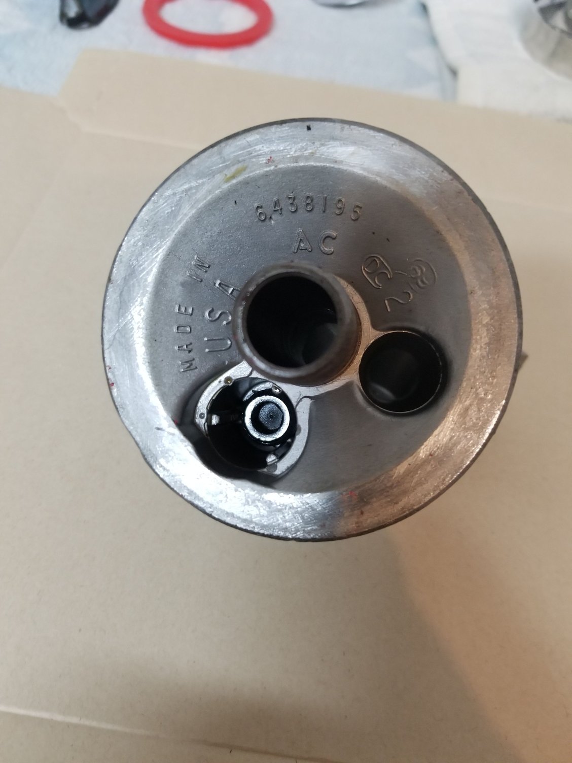

Just to be sure I'm not going to *&%# up my oil filter housing by doing something wrong I took these picturesto help explain what I have done so far and get feedback on how to proceed.
I took a small screw driver and started pushing down on what though was a screen, spring pressure was weak, I can see why these things are aways passing oil by the filter.
After pushing down on what I though was a screen, it flipped onto it's side and I grabbed it with neednose pliars and gave it a tug, it broke in half and basically fell out. It's made of some kind of carbon clay crap. Pictured below.
So do I remove this steel washer looking seat that held in place by stress risers created by someone using a punch or do I leave it in and tap threads into it. Not much there to make threads in or do I remove it and tap the bore under it in this cast aluminum oil filter adapter?
Last pics shows the oil releif spring still in bore under the steel seat. As you can see, the steel seat washer looking thing isn't very thick so making thread in it won't produce much for a plug.

I'll try to answer these in order:
First off you have to remember that you're dealing with 40-60psi. That fiber washer is maybe a 1/3 of a square inch in size so it's going to see roughly a 1/3 of the pressure generated. Maybe that's why it feels weak to you or maybe it really is and the spring is shot.
That steel washer that is peened/swedged in there needs to come out along with the spring and anything else under there. You do not tap the washer but rather the parent aluminum housing it's pressed into. That hole is obviously bigger than 1/8npt. I did say 1/8npt because that was what I read to do. If the hole is bigger then that then move up to a 1/4npt, either way you are sealing the housing.
No I have not personally done this to my oil filter housing but will be doing it soon. Let's face it, if anything big enough to clog that port gets in there your engine is toast at that point anyway and if your filter is that clogged that the bypass is being used you have bigger problems than this plug will ever cause. Change your oil often, keep it clean and use a quality filter like Wix or Napa Gold (Wix). This isn't rocket science it's simple mechanics. I don't mean to sound smug but I've worked so much with metal that this kind of stuff is second nature to me and I just think it's straight forward in how I've explained it.
Pipe plugs come in a bunch of styles: allen head, hex head, square head, common screwdriver slot, etc. What you use is up to you but yes the allen head would be flat and probably your best bet. Just keep it below the oil filter sealing surface.

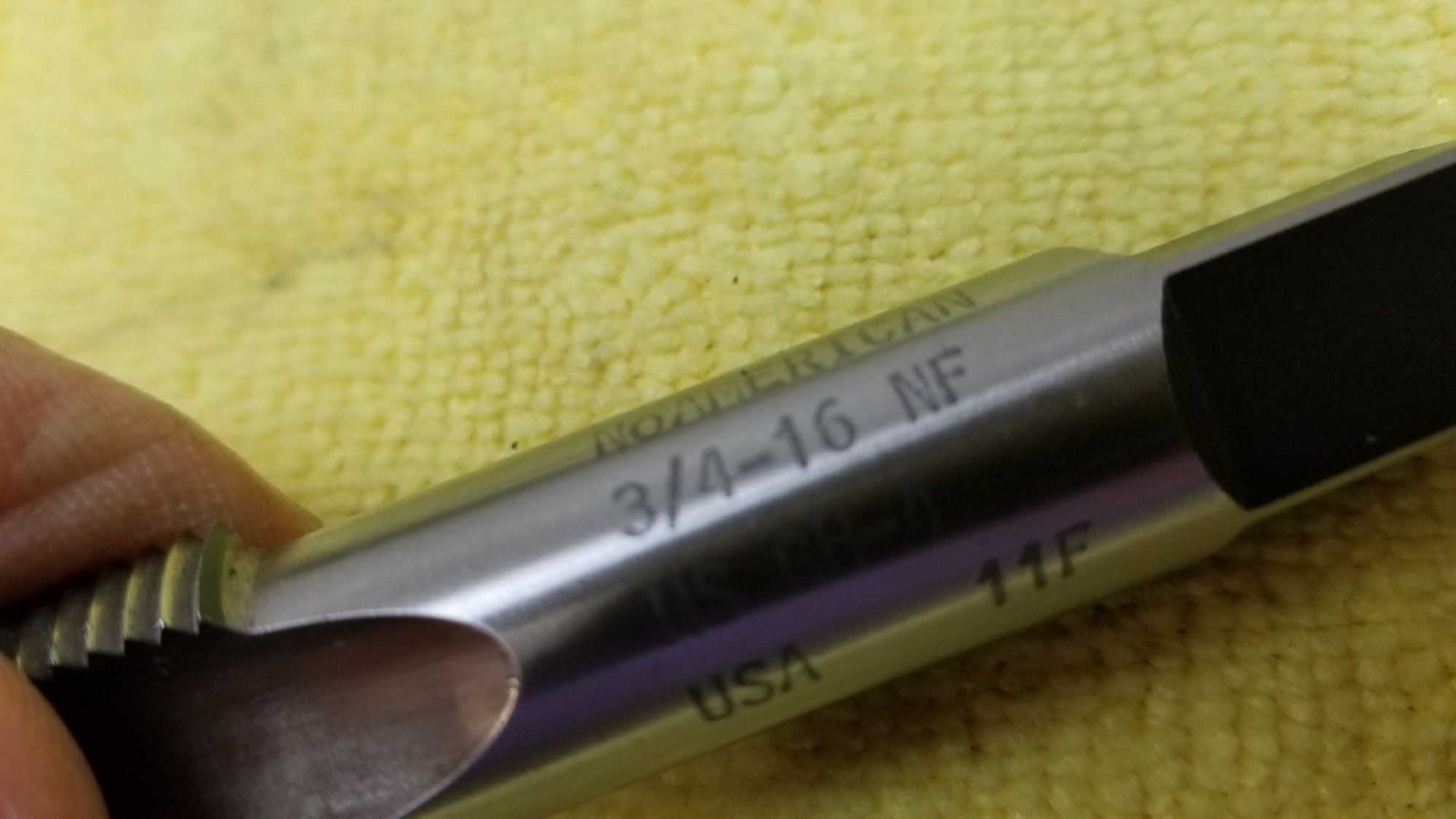

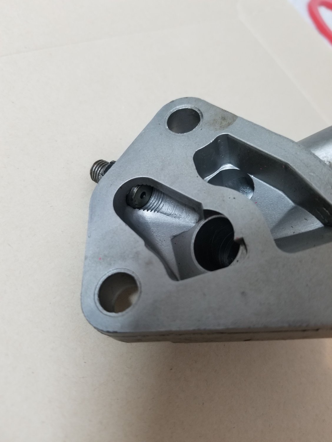

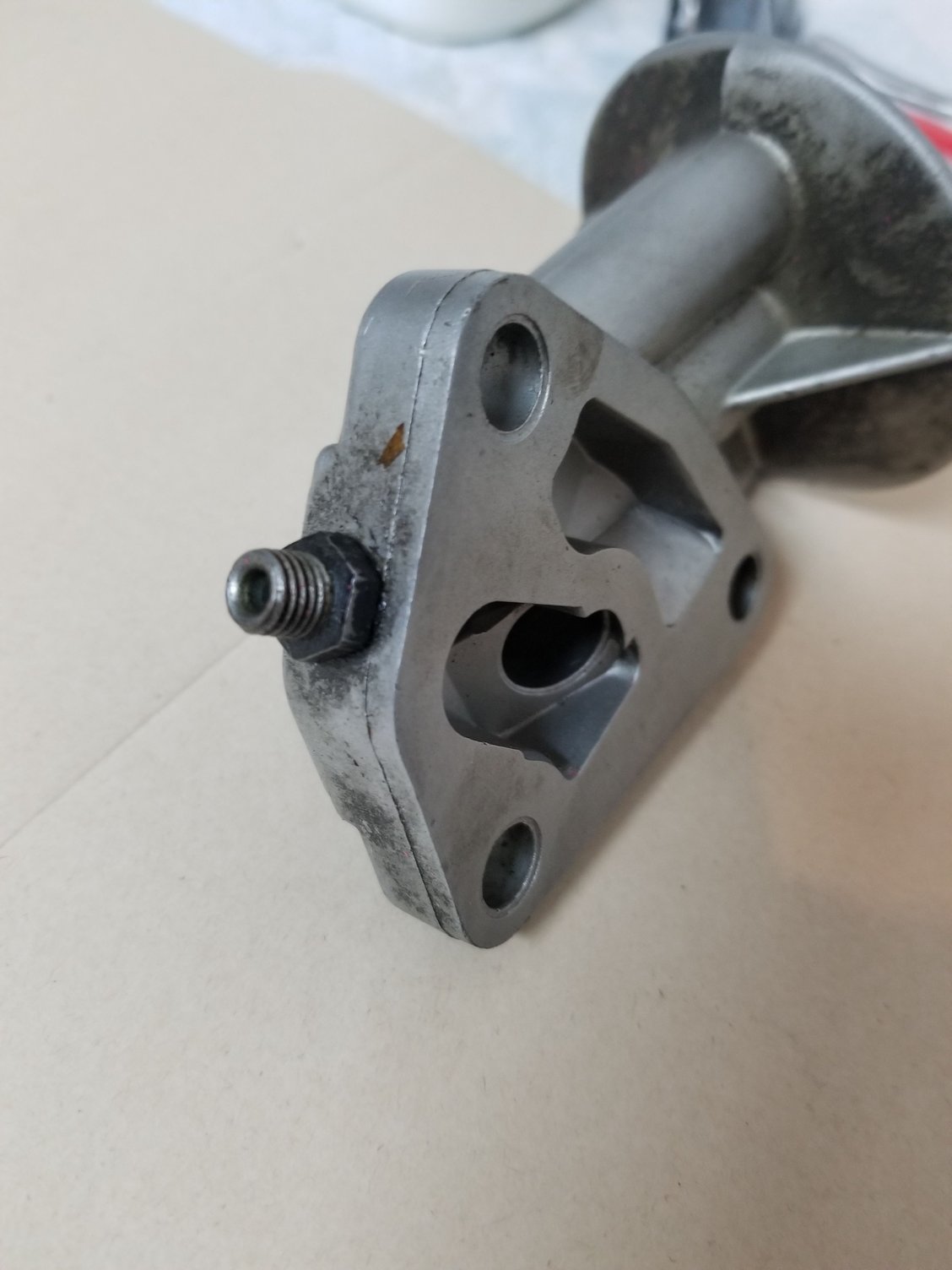

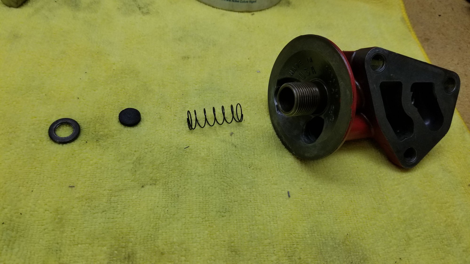

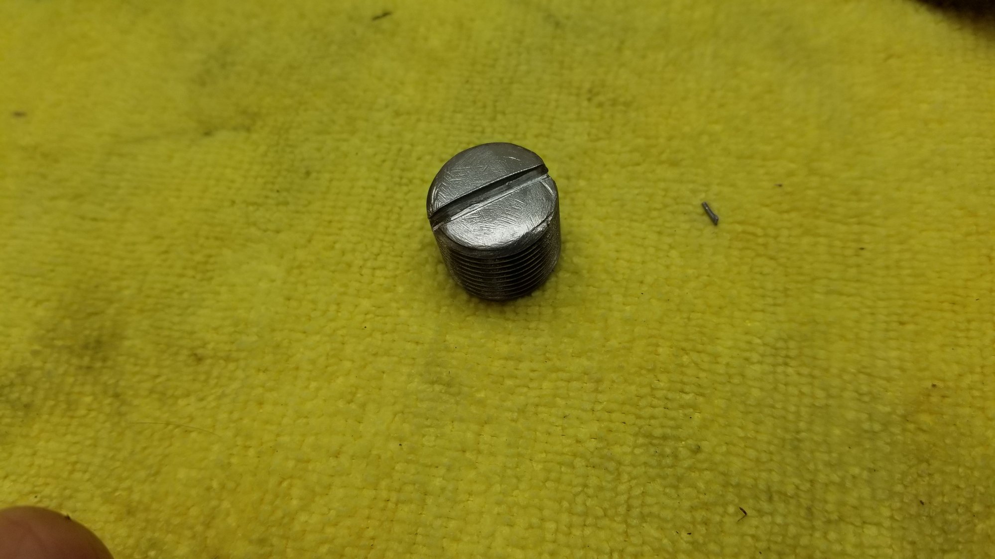

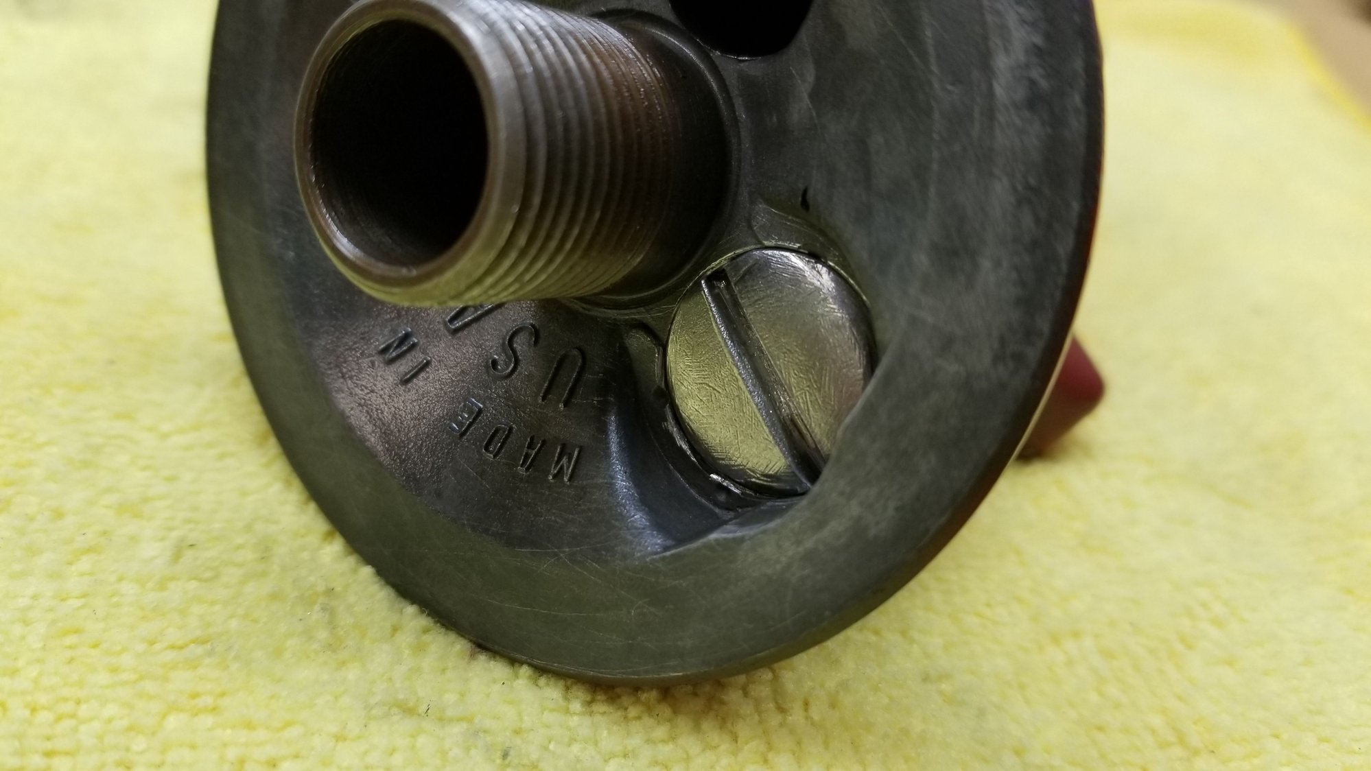

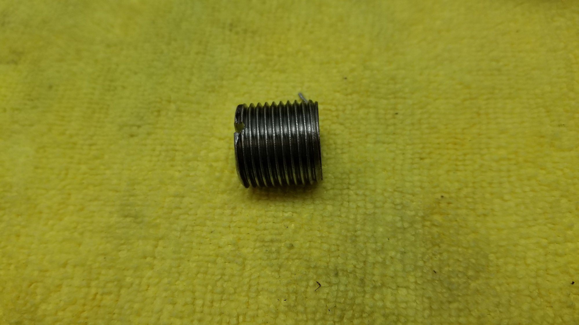

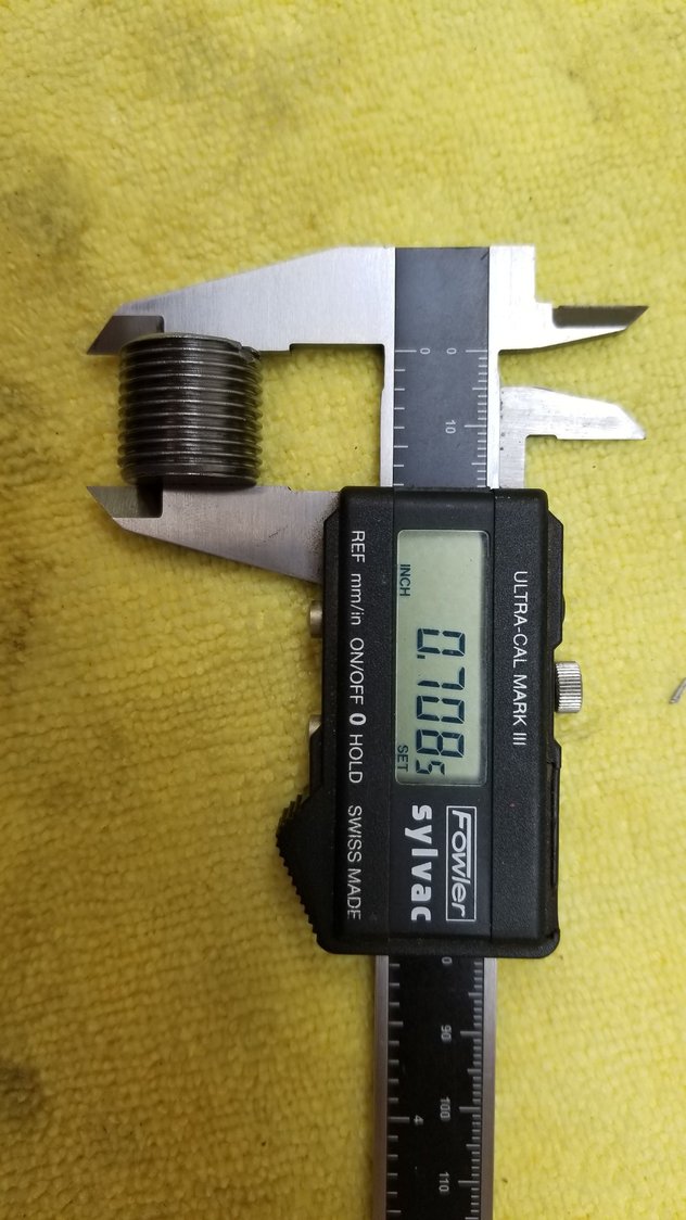

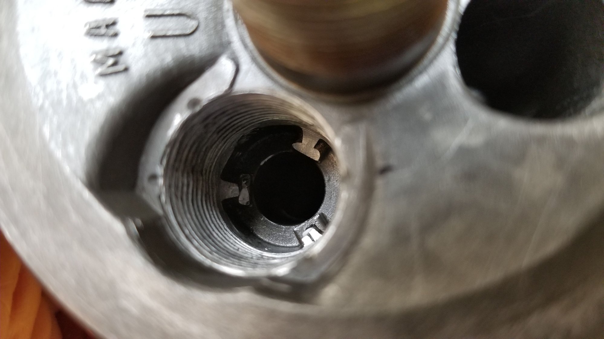

I just plugged the bypass on my engine. Hoping this helps out other people executing this. It's a bit tricky but fairly easy. After i popped out the ring which holds the plate & spring, I found 3 ribs extending down the bore. I used an air tool with a crosscut bit and leveled it. Once complete, I then ran a 3/4 fine tap to the bottom. Next, I used a chunk of 3/4 fine all thread, carved in a slot for a screwdriver and drove it to the buttom. Once bottomed, I peened over and edge so it could not back out. hope this helps. Eric

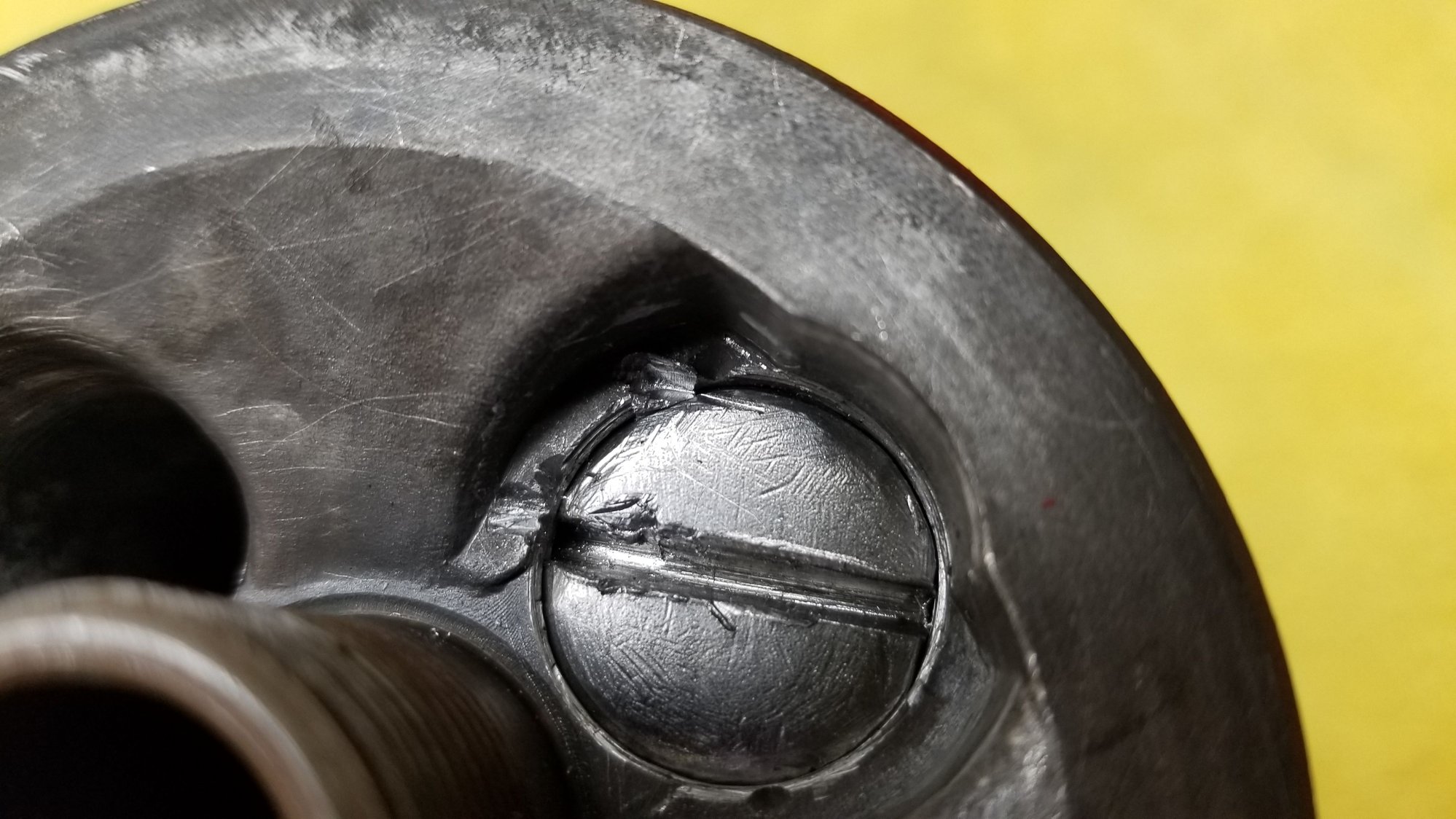

Since this got reopened, here's my oil filter adapter with bypass plugged (1/4 npt pipe plug) and oil pressure tap (1/8 npt adapter). I would not recommend either for use other than on a race only build. Adapter is pretty thin where I installed the oil pressure tap and I was very careful using a tapered pipe reamer after drilling a pilot hole prior to cutting the pipe threads.
