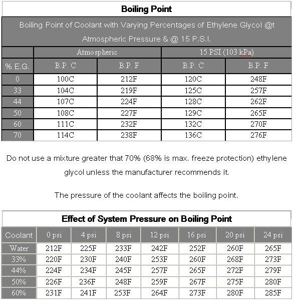

Being down in Texas, you can probably do a 70-30 mix, water to coolant and throw in something like water wetter in as well. The 50/50 mix is strong enough for Saskatchewan winters, trust me, I know. Coolant doesn't remove heat as well as water but raises the boiling point and helps prevent corrosion.
Old Mar 20, 2016 | 10:11 AM
  #60
Posts: 15,410

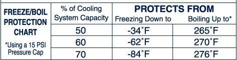

Correct, but the increase in boiling point is minimal, like 17ºF for a 50/50 mix (from 248 to 265 with a 15 psi cap). As you said, its real purpose is to prevent freezing in severe winter conditions: a 50/50 mix reduces the freezing point by 66ºF (from 32 to -34):

The 15# cap is what helps the most as far as boiling point.
