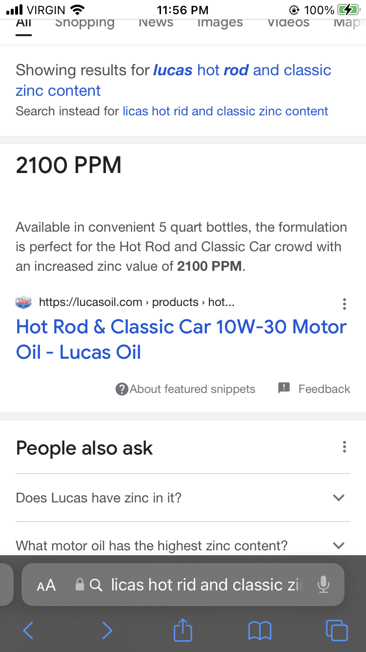

I only use Lucas hot rod and classic in flat tappet builds. It has 2100ppm zinc content.
Valvoline VR1 has 1400
