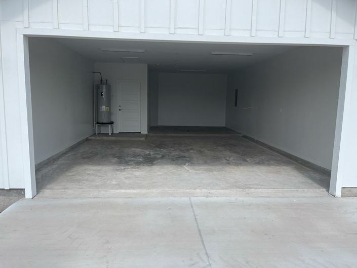

New home moving to. Has an extra large space in the garage. Room for all my tools. Bench and engine stand.

Sounds like you are well set up for all that power. Just wait till you move all your tools in. You will say, where did all my space go?😉

Work in a an old small garage That I could not get the car into. New home space is wider.

I hear you my car just barely fits as well with all my crap in my 14x24 Garage. The best investment in a small garage is a quiet air compressor. My Hulk compressor puts out good numbers and is only 40 DB. Bernard told me the same thing about the Procomp heads, he would not mill them that far. I messaged Mark about the rest of my parts, I am getting springs and pushrods for the iron heads, just in case. He has been very tight lipped about the Edelbrock SBO heads, hopefully he ships my parts and makes a new thread about the new heads. He had multiple builds going last response I got from him, I know he is pretty busy. That is a nice looking motor by the way. I assume Benard did his basic work to the heads in the port opening, you may have more power than you think. What cam is in your current motor?
