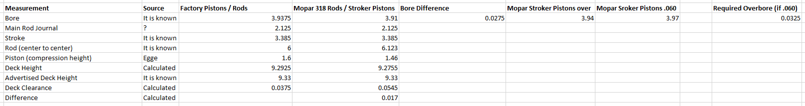

Good afternoon everyone,
I'm looking into piston options right now, specifically for the 330, and came across some past threads where those with 350s are running Chevy Pistons with the crank machined to accept the 2" rod journals.
I also came across Mopar 318 stroker kits and thought this might be a potential option - going with a .030 or .060 over 318 aftermarket forged stroker piston with 6.123" h-beam rods. Rod journals are 2.125, stroker pistons are available in a 1.46" length. Flat top pistons are available, as well as some other options. Prices for rods and pistons look reasonable.
Here's what I came up with:
Let me know what you guys think. It seems like this would be an easier path than boring the 330 to use Chevy pistons and changing the rod journal to 2" on the crank, and could be done for 350s as well, as the 360 pistons have an approx. 4" bore & the rods should work without machining the crank, unless I'm missing something.
Note: I'm only calling them "stroker" pistons because they're a shorter compression height than the typical 318 pistons.

Lots of folks have used standard 350 pistons (4.057" diameter) in the 330 block. From what I have read, just sonic check the block to ensure there is sufficient cylinder wall thickness before boring the block.
Or, there are 330 pistons availabe from Egge, Kanter, SupercarsUnlimited, etc.
I'd seen the blocks can be bored out-- makes sense as the factory was configured for the same bore spacing. I'm planning a turbo build so I'd prefer the extra wall thickness over the cubes, but the piston availability aspects might push me towards a 350 bore (either chevy or Oldsmobile)
I haven't deep dived into the costs of buying short blocks, but I would think it might cost as much to bore the block to 4.057 as it would to pick up a 350 block to work with. Especially with the cost of the sonic-check baked in either way.
I was thinking it might be possible to get away with just a hone for the .030 over 318 pistons. A .013 clearance is too much to run the stock bore 318s. The .030 overs would be .0025 over, which I think would be good with just a hone.
I guess I'd have to get the block inspected to see whether the bore is in good enough condition for just a hone, and if not may as well bore to 4-4.057" where piston selection is better.

Yes, some on here have offset ground the 330 crank with a sbc 350 piston and rod. The 1.56" compression height with a 6" long, 2" journal rod works with the 3.5" stroke 350. I plan on doing the same thing with a sbc 4.125" piston, since I have the 6" rod and stroked 330 crank. I looked at the Mopar rod, too narrow on the big end, I believe.
Yeah, I did see that the width is a little different on the big end. The big end width of the SCAT H-beams is .925, versus the .935-.937 of the stock Oldsmobile small block rods. I figured that was probably OK as far as having an extra .005" on each side, or that there might be a way to adjust for that, but I was worried about that! Is that extra play pretty much a deal-breaker?
Haven't looked into the other H-beam rods enough (false match led to this edit) but I'd imagine they've all got that same width at rod journal.

Originally Posted by 67OAI
Many 330 blocks have really thick cylinder walls and as stated above can be bored to 350 size (4.057"). If something like that is to your liking, Mark Remmel (CutlassEFI) has the stroker kits available and I think he has a piston in 4.065" available to go with it. Best to have your block sonic checked first! Another piston choice for the 330 is the Egge 4.00" bore flat top listed for the '65 to '67 400 CID Olds. Unfortunately that one is not a forged piston and is about 80 grams heavier than the 330 piston. Lighter is always better!
The Egge was about the only I'd found with specs listed for the 330. That's quite a bit heavier for that 4.00" piston! I think forged is the way to go if I'm going to use anything other than stock.
It seems like if I'm going to stick with this block boring it to 4.0 or 4.057 may be the way to go; or I may want to research picking up a 350 block that's already been sonic-checked.
I guess a final option is paying the extra money to have custom pistons made...
