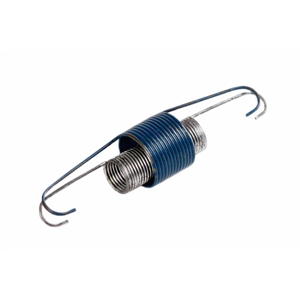

After reinstalling the carburetor back onto the engine (403 V8) there were two external springs, one I was able to figure out one of them was the throttle return spring. But I'm at a total loss for the other. I vaguely remember it is connecting the secondary lever to *something*, which makes sense since the secondaries don't seem to open when i simulate wide open throttle. I get the sense I'm missing something very very obvious, but as I'm new at this not everything is as obvious as it should be.

That is 100% normal as the QJet secondaries are a “demand” system and don’t open with no load (as in revving while in park or neutral).
Ok that makes sense. Then the spring must be some kind of return spring for them?

Are the springs similar to each other, does one fit inside the other? If yes, they may both be throttle return springs.
I admit that thought never occurred to me, I will have to try that when I work on it again this weekend. Thank you.
Old Oct 16, 2024 | 04:57 PM
There are two return springs for redundancy. One goes inside the other.
