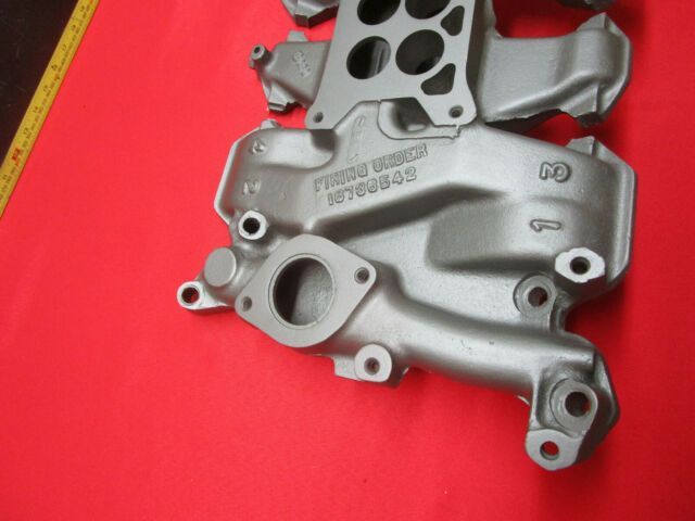

The firing order is on the intake manifold.

For future reference, the firing order is marked right on the intake manifold.
Thanks very much, you are right, I should have known... :-)

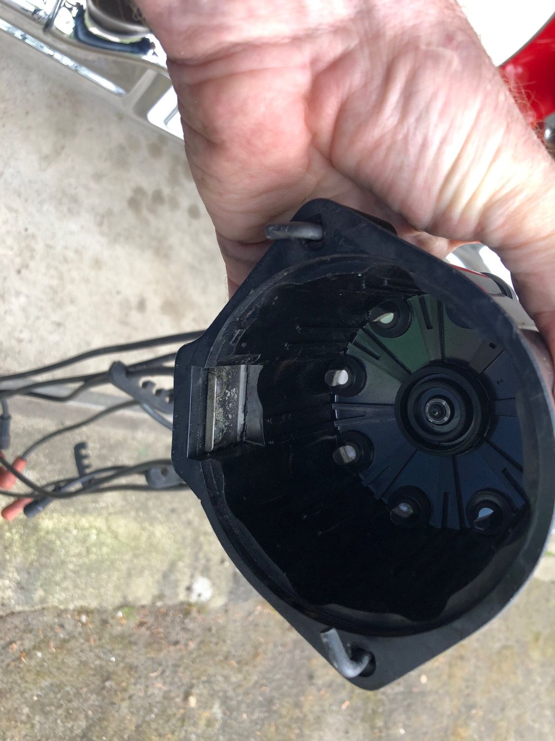

Guys, sometimes the American standards can drive us crazy over here in Europe. :-)))))) I got the wiring right now, but I cannot get the distributor cap fixed to the base as these strange "fingers" that you see on the photo do not seem to make any sense to us. They only go down with pressure when the finger points inward towards the middle. Once the fingers are set that way, we cannot put the cap on the base anymore. So, we put the cap on and try to turn the fingers towards the middle, but that does not function. They wont turn and I cannot press them down unless they point to the middle! Aaaagrrrrrrrrrrrrrrrrrrrrrr . Over here, we fix the caps with flat steel springs that you just press in on the outside of the cap and finish...
Pls help, I cannot understand your system. It will not work, no matter what.

Believe it or don't, the 1956 was the first year that had the "improved" distributor. The 1955 and older used the flat steel springs to retain the cap. The design you have was used for many years.
Here is the way to use them: With the retaining "legs" pointed inward, compress the springs completely and while holding them in the compressed position turn the leg counterclockwise (viewed from above) about 90 degrees. The cap will hold the springs in the compressed position. Place the cap on the body of the distributor, and while holding it in position rotate the fasteners 90 degrees clockwise. The cap should then be fastened properly. There are two raised portions in the underside of the distributor's body, between which the leg should rest.

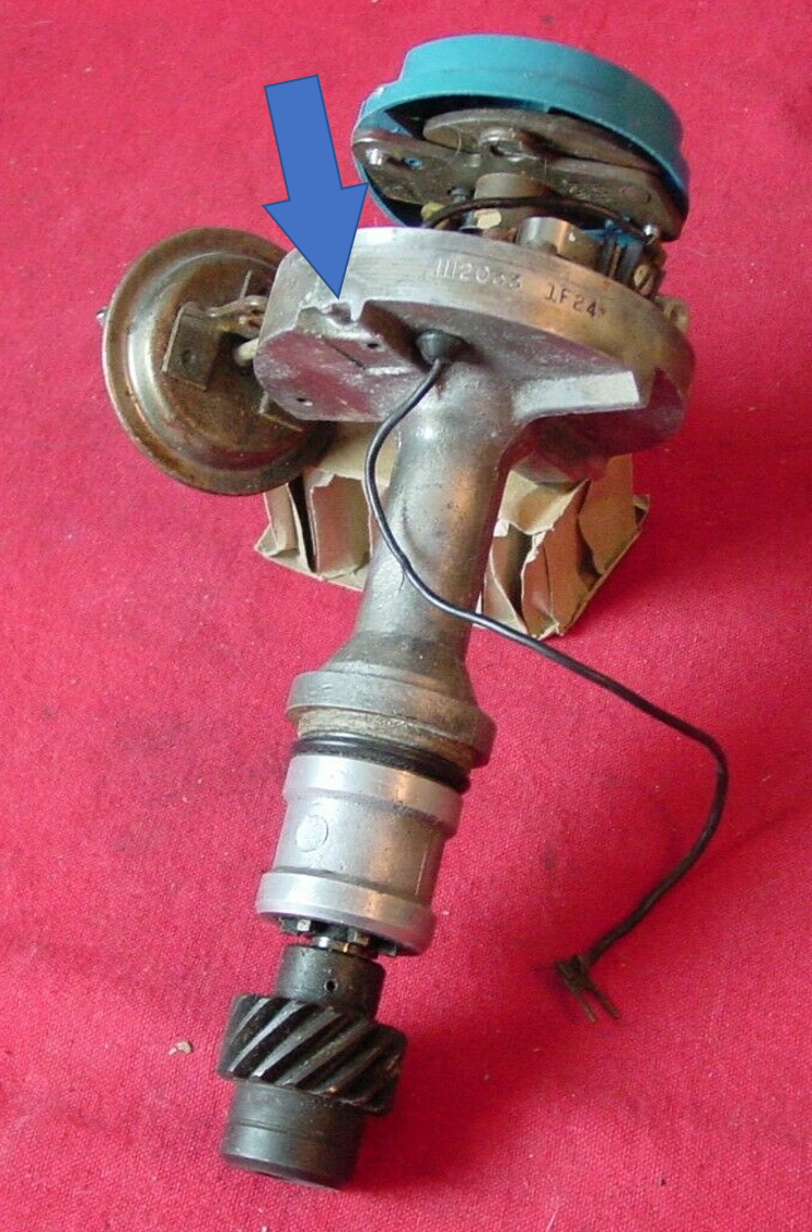

New Delco window distributor caps like that are typically shipped with the retention hooks in the "storage" position. The hook has a key on the shaft that fits into a slot in the hole. Typically you need to pull the hook down by hand, sometimes you need to gently twist the hook while pulling to align the key in the slot. With the hook pulled all the way out, rotate so the hook is pointed radially outward from the cap. The key will hold the spring compressed in this position. See photo. Note the square keyway next to the window (red arrow), which fits into a notch on the edge of the distributor body. Install the cap, align the notch, and use a flat blade screwdriver to push down on the hooks and rotate them 180 degrees inward into the recesses on the underside of the distributor. Done. This is much easier to do than to describe.
