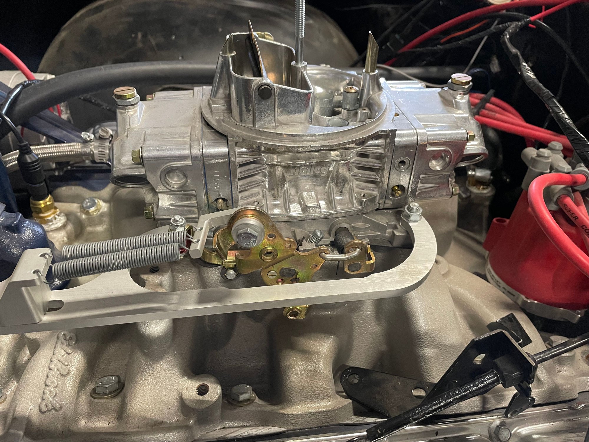

I need some ideas on the best way to attach my throttle and manual choke.
Is there a bracket available for each cable (throttle and choke) that will mount to my Holley 4150?
A complete new throttle cable maybe?
I have the original cable and bracket.
