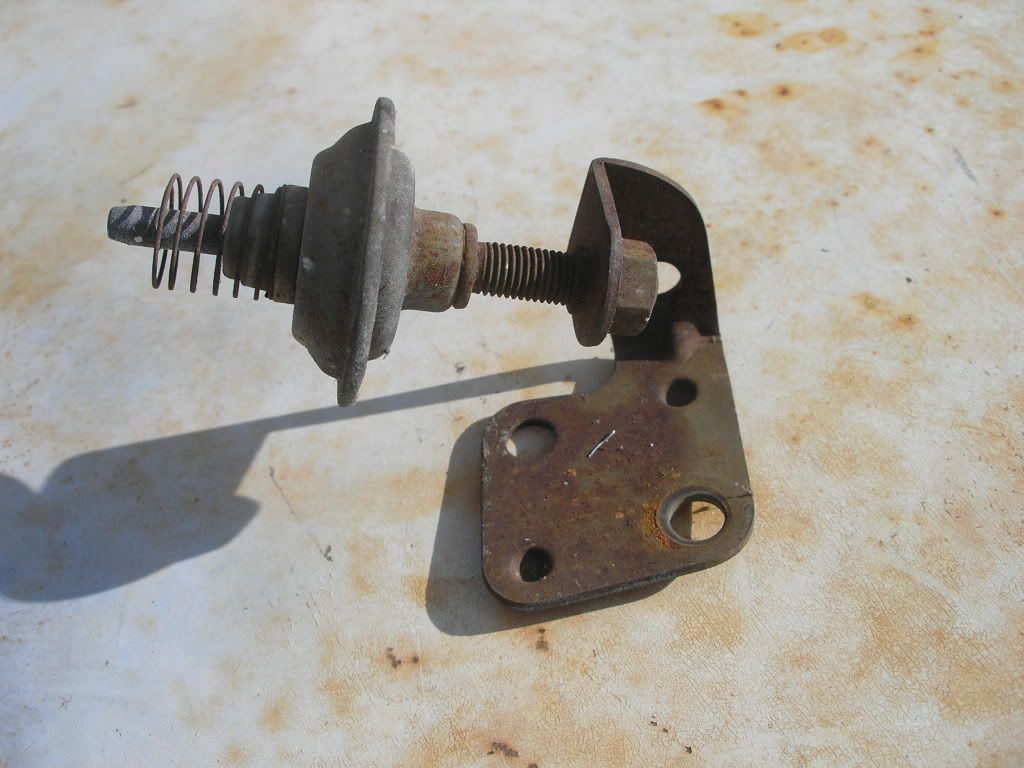

Hey there I have a 72 supreme with stock 350 was under hood today just evaluating things, saw these two parts and have a few questions. The first part is on the passenger side valve cover with hose that runs up under the air cleaner, cover. What is this, oil breather? It is shiny now because I wiped it off but it was completely covered with what looked like oil, I assume this is not good, time to replace? The second part looks like something emissions related, it is the cylindrical piece in the pic it is located in front of the accelerator spring and it looks like it should have a hose attached to front but it is broken, what is this? should It be re-attached if so to what? Thank you.....I tried to attach pics hope they came through

1st pic is a crankcase breather 2nd is a carburetor dashpot

To add to the description, the breather on the valve cover connects to a filter inside the air cleaner housing. You can replace that filter if needed. The breather on the valve cover simply has a screen in it and usually doesn't require replacement.
The dashpot does not have a hose connection. It is simply a "shock absorber" so the throttle blades don't slam shut too quickly if you release the throttle rapidly.
Out of curiosity, what on this thing does it look like the hose should be attached TO?

Looks like little post on very end

Are you talking about the plastic part closest to the carb?
If so, no, that's simply the guide for the (missing) metal plunger that is supposed to be contacting the throttle arm on the carb.

Bey thanks bud I knew something was broken from it just didnt know what thanks again
