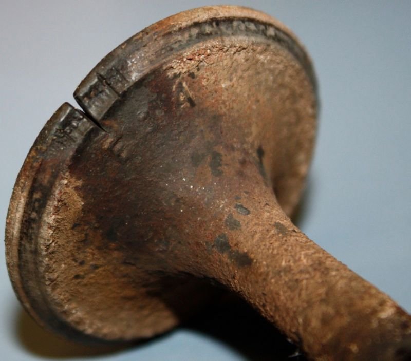

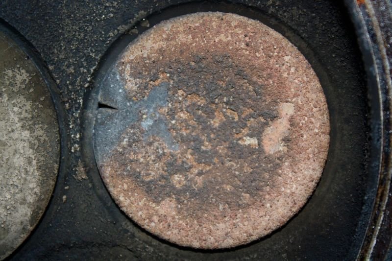

Burned valve:
- Eric

Thanks for the pics, I can see how the valve gets damaged..and the leak by!

Lean mixture and inadequate closing time (due to a bad valve adjustment).
Other than that, just wear and bad luck.
By the way, you will note that the exhaust valve seat was not recessed into that head, at 106,000 miles, in a high compression 350.
