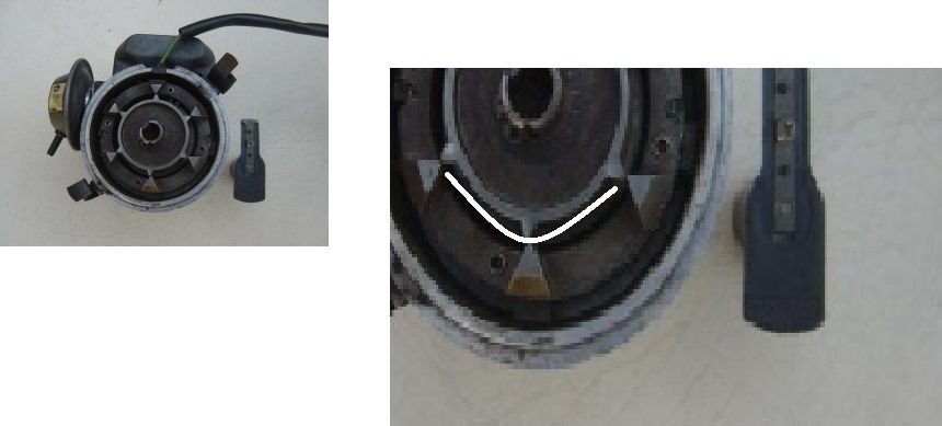

Originally Posted by cjsdad
Usually when I adjust a magnetic pickup I put a piece of newspaper between the two pieces and tighten it down. That way I can be sure I won't have contact but they are about as close as possible.
woah..like this??
Hmm...that's a great tip. Hardly any space in between though. Should try to get a paper strip in between. Thank you. I will update the results soon.
If on that particular distributor one point is supposed to be closer than the others, then yes. If they are all supposed to be equal distance apart then you will have to use a feeler gauge to get them all set.
No no, I just took this picture from internet because of clarity. I was fixing the standard computer controlled dizzy on the 87 307.
Inner and outer spikes hitting each other is out of the question, as they just bind and no rotation happens then.
The chassis manual doesn't say anything about one point closer than others or anything like that.
Wanted to know how a factory fitted dizzy feels like when you rotate the shaft at the bottom.
Whether it is just a purely smooth revolution (similar to ball bearing feel) or with slight taps felt to fingers when you rotate it.
