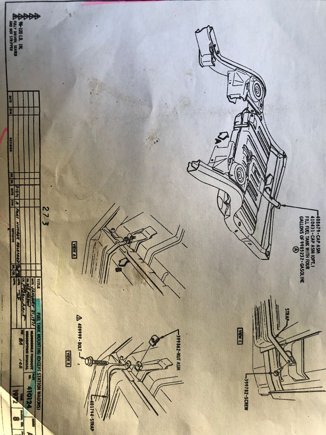

OK, I may as well just try it from the tank. Before I fill the tank though, how do I know how far in the bolts to mount the tank should go. The tank is new, and I’ve got it mounted so that about half an inch of the bolt is coming through the other end by the frame. I took it down just to make sure that this wasn’t up So high that it would crush the sending unit lines. So I know I can go at least a half inch poking through the frame side, but I’m not sure that that’s enough. I have attached a picture from the assembly manual, but it doesn’t tell me how far in.Although now when I look carefully, I see a blurry footnote that says “fully driven seated and not stripped”. However, since I can’t see exactly what the footnote is referring to, I’m not sure if it means the bolts at the front of the gas tank. Thank you!
Old Jun 24, 2020 | 05:59 PM

Posts: 1,287
From: Southern New Jersey
Well it seems that I can’t go any further in with the bolts at the front of the tank than 1/2” because the fuel tank sensing unit metal supply line is already touching the underbody. I’m not sure if I installed the tank incorrectly or if anyone else can feel on top of their tank to see how far their front bolts are protruding through the bolt hole and how far from the underbody the line for the fuel sending unit is. Thank you!

The foot note is telling you to torque bolts between 96 to 120 inch pounds.
That’s 8 to 10 foot pounds.

Ok. So am I to assume that the bolts protruding 1/2” through the frame tabs is all I need to keep the tank secure? Can I trouble anyone to check this on their cutlass? Thank you!

The bolts sticking through 1/2” is fine but what to need to be looking at is how the straps tighten to the front of the tank. You don’t want to pinch the tank and you also do not want a gap between the strap to tank. You’re “fitting” everything together.

Ok. I see what you’re talking about. There is about a good 1/3” to 1/2” gap between the strap and the bottom of the tank near the front of the tank. See photo. Does the tank have that much play that I can make that gap flush? If so and I can drop the front of the tank down to meet the straps then that will get me a little
gap between the sensing unit and the underbody which i think would be good.
