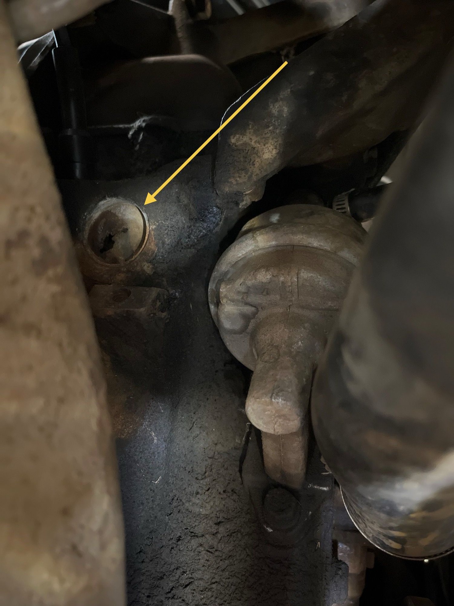

Hi, can anyone please confirm the freeze plug size depicted here on the front passenger side of my 1968 88 with 350? Hole measures a hair over 1” (27mm) with poorly positioned calipers. Thank you.

The freeze plugs in the cylinder head are 1.25"
