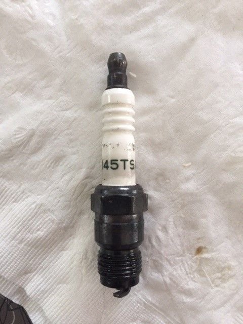

The plugs I took out are AC Delco R45TSX but everywhere I look it says these are not for this engine.

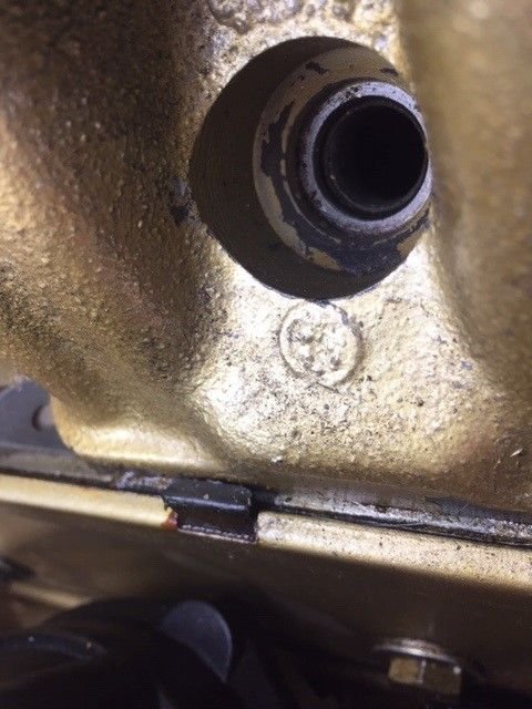

Here's a few pics of the plug hole an engine side shot.

I'm working off of a phone at the moment but TSX is tapered seat. That head looks flat and would use a ring washer seal plug not a tapered plug. Somebody with better image access please jump in.

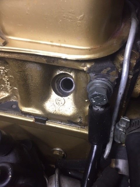

Here's some close ups of the plug hole, the plug and the engine bay.

To me that plug hole looks like its designed for a 13/16" hex gasketed plug not a 5/8" hex tapered plug.
Though it looks like a slight starter taper/chamfer exists as it goes down into the hole. Chamfering is a common machining practice. If it wasn't for that chamfer the tapered R45s would not have worked at all. Doubt that starter chamfer is the correct angle for a tapered plug.
You have to be concerned about the plug depth. Chevy commonly used 3/8" reach gasketed plugs in 68. 3/4" reach was for aluminum heads.

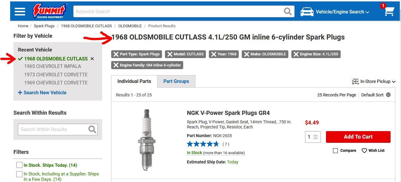

Doing a little searching on various 250 web sites would agree with all of this. Id surf around and post the question or three if you need further validation, as I'm not a 250 Six expert.
AC R44XLS,NGK BPR4ES, etc are all gasketed plugs. A quick gander at Summit, plugging in the 250 Six resulted in gasketed plugs.
https://www.summitracing.com/search/...ine-6-cylinder

By your picture, the recess in the head does not look deep enough to interfere with access to the hex on a gasketed plug.
Yes, it would prevent a 13/16" socket from bottoming, but that may not be required to engage the hex on the plug.
Buy or borrow a single 13/16" gasketed plug to see if this is correct.

Yes, I believe it should have a gasketed plug. Its hard to see in the picture but it is flat so the gasket makes sense. The AC R45XLS looks like it might do the trick. Its always run a little rough and doesn't smoke at all so maybe the tapered plug that was in there made it run a little off. With new plugs and a timing reset, I'm hoping it will run smoother, though it doesn't run poorly at the moment. I may replace the plug wires too depending on how it runs. Couldn't hurt.

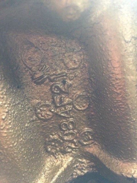

Here are two pics of the rear passenger side block and the passenger side head.

Block is a 64-76 230 or 250 CID Chevy block. The head casting # is different than supplied, it should be raised and all numeric characters similar in format to the block.
