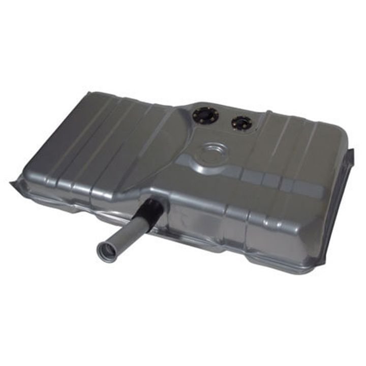

I can't find any EFI ready tanks for an olds.
They're called "Chevelle" tanks. Holley even sells one under the Sniper brand.

Holley part number 19-125 is the Cutlass/Skylark specific EFI conversion tank. It comes with a 255 liter per hour pump that will support around 500 hp.

That tank is for a 70-72. Go read the first post again. The OP has a 1974.
My bad.
I had a 1974 Grand Prix, and the tank was completely different than a Chevelle. the top of the tank was shaped differently, and the filler neck was different. I don't know if the Olds tank is the same as Chevelle for 1974 or not.
