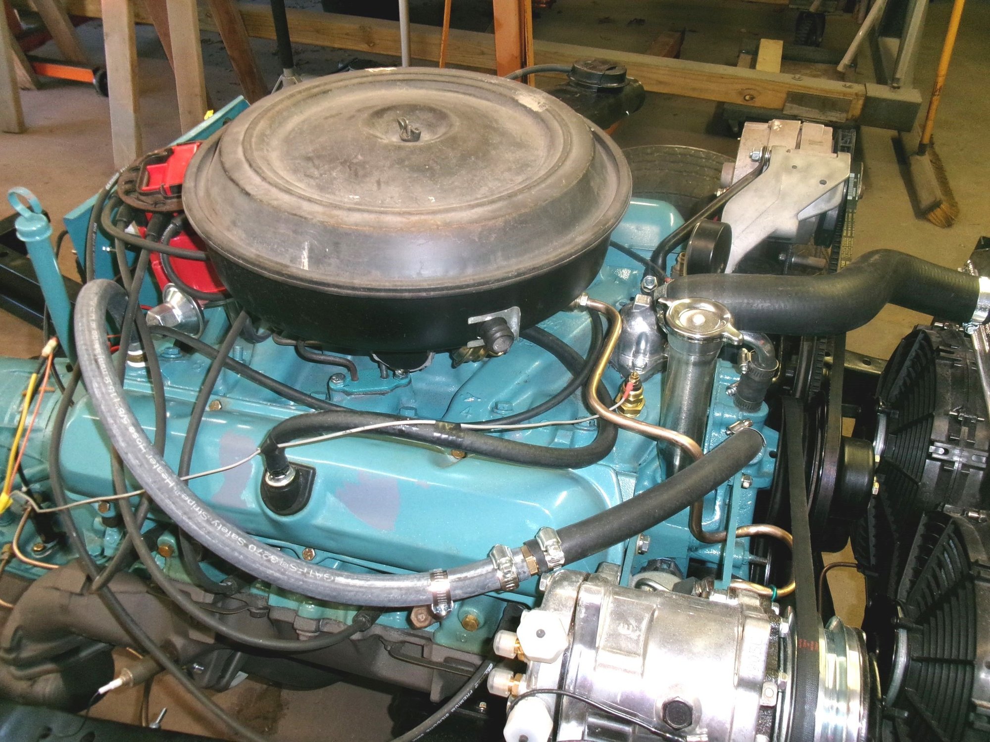

Gentlemen,
I need your help again. I am installing an under-dash AC/Heating unit and need to tap into my heater hose. I am thinking that the flow in the picture is from the back to the front? Is that correct?
Thank you,
Charlie D.

The port at the rear of the intake goes to the inlet of the heater core. It is 5/8" hose. The port at the water pump is the outlet from the heater core. It is 3/4" hose. The larger hose is always the return line because the pressure is lower after passing through the core.

Charlie , In your picture you have the 2 coolant lines connected , that means you needed a 5/8 to 3/4 inch adaptor or maybe the 3/4 hose is too big for the 5/8 fitting on the intake manifold . i have a few older cars , i always have a 5/8 to 3/4 coolant hose adaptor with me if i go out of town in case a heater core lets go .
Another way to word this is , The smaller 5/8 hose coming from the back of the engine is the pressure side of the flow . The larger 3/4 hose at the water pump is the vacuum side of the coolant flow / vacuum side of the pump . As any pump has a vacuum side and a pressure side.
With cars that have AC there is a coolant flow shut off valve mounted to the intake manifold at the back , or just off the back of the engine . The coolant shut off valve is vacuum controlled . So when the AC control on the dash is in the AC MAX position , the valve closes . Stopping hot coolant from going to the heater core . So what i am getting at is seeing that AC cars came from the factory with a coolant shut off valve in the 5/8 pressure side , cars with no AC could install a shut off valve in the 5/8 pressure side, to stop coolant flow to the heater core in very hot weather . I have AC in my car but still installed an extra inline shut off valve , i close it off in hot weather / helps keep the cabin cooler, most days do not even need the AC on !
I would also think this extra coolant shut off valve would be a good idea for race cars that have a heater core or drivers that have a heavy foot , protects the heater core when engine is at red line .
Charlie another thing to keep in mind if you replace the 5/8 coolant hose fitting on the intake manifold .The fitting has a restriction , or it will be too much flow / pressure going to the heater core . ThIs nipple with restrictor was mentioned by Joe in his May 4 / 2024 above link / post.
Don't over-think this. I've used a 5/8" connector and just clamped down harder on the hose clamp.
