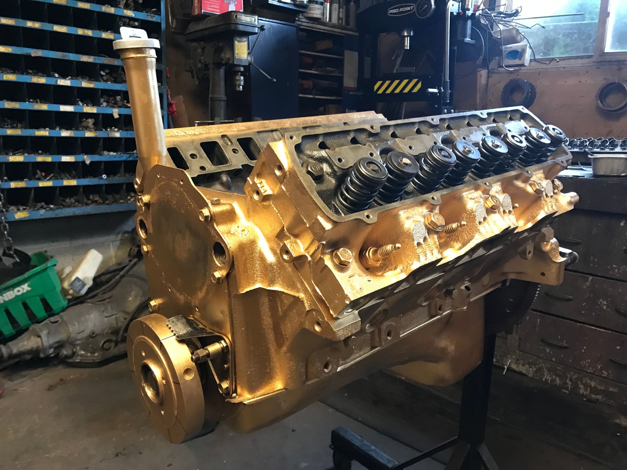

The set up I have is a ‘74 Rocket 350 block, pistons and everything stock. My 71 heads rebuilt. The cam is a comp cam. I have attached a picture of the one I got from Summit.
