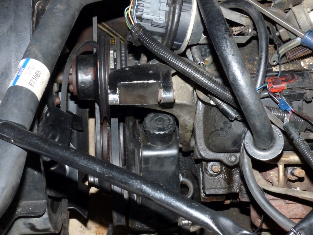

Well, this took a turn for the interesting tonight. I shone a light and got up close and personal with that area, finding that there was a large shim installed.
When I got my head right up next to it, I realized that it was blocked... but not by a broken bolt, but because the large shim had slipped up, blocking the hole almost entirely. I ended up loosening the block mount nut (which required removing the knock sensor) and using a large screwdriver to pry the engine up and the shim down, allowing the proper bolt to go in place:
I measured the shim and it is 0.310" thick, so I added a 0.090" washer I had laying around and then installed the lower bracket on:
And now the power steering pump is almost perfectly aligned:
I tensioned the belt tonight and it seems to be ok. Obviously firing it up will tell the tale, the power steering pump bracketry is missing 3 bolts so I have to hunt those down to finish up.

That is different then my 88 Cutlass. Olds did usually tie in the back of the power steering bracket into the motor mount bolt. Mine has a tail off the pump bracket that goes over top of the mount. Quite often the brackets were different to fit different bodies and options.
Old Sep 14, 2017 | 07:14 AM
Posts: 50,818
I forgot this was a Caddy and not an Olds. For some reason, Cadillac used different motor mounts and frame mounts than did Olds in the same chassis and with the same 307 Olds motor. Go figure. Most of the Fleetwoods I've seen with the 307 actually use Chevy clamshell frame mounts and metal brackets on the motor that look like the 403 Trans Am brackets.
This "shim" actually looks a lot like the adapter used to slide the motor mount forward on the Olds diesel motors to clear the larger starter. Since this is an 89, it could not have been a diesel. I wonder if the frame mounts are actually Caddy 4100 mounts and this adapter moves the motor mount accordingly? Is there a similar adapter on the passenger side?

Well, got engine all back together tonight and fired it up. Squealed like crazy... from the water pump. The A.I.R. belt was nice and cool after 5 minutes of running but the alternator and the power steering belts were soft and gooey and WAY too hot to touch. Smoke started pouring out from underneath the fan pulley setup. And the alternator isn't charging. Looks like the water pump bearing is toast. Guess I'm pulling it back apart and replacing it, not sure how someone can botch a water pump install.
The alternator belt is REALLY close to the water pump pulley. It seems like it should be spaced at least 1/4" apart from each other but this is more like 1/16" if that. How much clearance is there supposed to be between the two? Service manual for this era is pretty useless in that manner.
